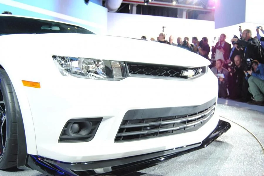

As long as there is no AC condenser... The 2012 Boss 302's were removing the grill to help cooling during SCCA events. It is a common problem with '12 Boss's. 2013's were fixed...
Here is a close up of the Z28's fascia. The lower air dam is blocked off about 1/3 of the total area. The upper grill area was reduced by at least 50%... The removal of the AC wasn't really for bringing the Z28 home, it was done from necessity to keep the 5th Gen cooler from the design flaws.
The general feedback from 5th Gen fans is that "We hate it", "It's ugly" and "It's too squashed", "It's dumbed down" ... and they are correct in that assumption and that's just what they say about the front. While Chevy employees race to convince you that the 2014 is better, the poor Z28 has a lot of questions left unanswered. I'm sure they don't really want to get into this design flaw... You just have to see it in person :)

Good picture Pill. Blocking off a good part of the lower opening (why? -- bumper?) is not good. I'll more readily agree w/ your original assessment now: the inlet area appears smallish and restrictive. Removing the lattice work from both upper and lower grills will help, but no idea if that would be enough.
Still, back pressure largely determines mass flow through a 'duct' for a given inlet area. W/o seeing the under the hood, and underneath, it's really hard to get a feel for what the back-pressure might be. But, the inlet now looks considerably worse than before.
Unless GM can get enough flow by removing the grill lattice work, say good bye to racing (other than drag). That it doesn't meet the rules is almost beside the point now.
I initially found this amazing, much like KR and groundpounder, but then I recalled my experience w/ a 2500 Silverado w/ the Duramax. Terrific engine, but the rest of the thing was an utter joke. An aspect of that truck pertinent to this idea that GM will hamstring itself: It was a manual trans truck. The clutch slave cylinder would overheat, leak, and lead to the clutch pedal lying on the floor. This happened to me after all of 14k miles of very easy use (mostly highway miles, no towing or hauling -- using the good ole 95 Ford for that). Replaced under warranty. Replacement started to go at around 35k miles (total, so it lasted an amazing 21k miles). Went around w/ the dealer and GM some, when GM asked how I was using the truck. Told them (highway, no towing, hauling, nothing, exceptionally easy use). They countered that the clutch was not intended for such usage. I traded the f'king thing the next week for the F150 I have in my sig. I was dumb-founded. The dealership was good people, no complaints w/ them.
So evidently, the concept of a 'total system' escaped GM, and apparently still does.
One would have thought GM would have done CFD of the entire car, including underhood, so they would know (or have a good idea) the airflow through the radiator, and hence how many HP could be supported. Perhaps they did, but sacrificed cooling for its so-called 'pissed-off' look. Good decision, there -- for Ford and Chrysler.
