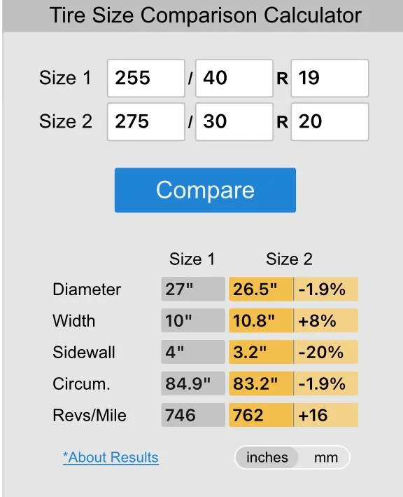

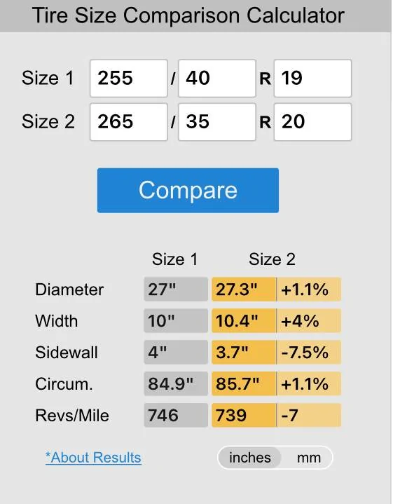

I just bought a 2020 GT that came with the 19" black out edition wheels. They are 9" wide wheels with 255/40/19 tires. I'm looking at upgrading to 20" wheels and I found an OEM set from a 2017 GT and they are 9" wide with 265/35/20 tires. The tires that are on the 20's are shot and will need replacing and I want to know how wide of a tire can I safely put on the 20's, front and rear with no chance of rubbing or effing up the stock diameter ratio too much?? The car is at stock ride height and I have no plans on lowering it. Thanks!!!

I believe 265 is the widest you can go on the stock 20’s.

275s fit easily on 9" wide wheels, 285s will fit too but it's work and tire shop will hate you (and there is no reason for that).
255/35R20 and is exact same diameter as 255/40R19. 265/40R19 is 0.3" larger - will make gearing slightly taller in the rear.
None of these are anywhere close to rubbing anything.

Go by the manufacturers recommendation. On a Michelin PS4S the optimum size would be a 255. A 265/275 would be on the max size but certainly useable. Anything bigger will just compromise handling.

So I can go with a 275/35/20 or would it be a 275/40/20?

Spend some time understanding sized, it'll help you a lot - if you want to keep the same diameter, 275/35R20 is what you need. This will keep speedo accurate and gearing unchanged. On line tire size calculators will tell you everything you need to know.
