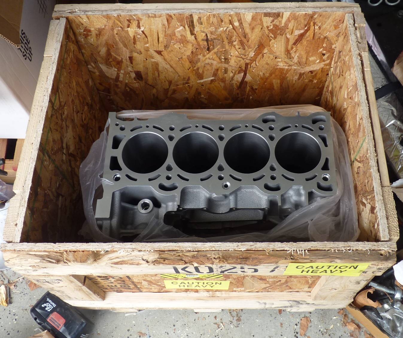

In that case, you would be looking for the 2.0L block which is a closed-deck block as opposed to the 2.3L one, which is open. In the US, the 2.0 comes commonly in the Ford Fusion. You'll have to find the best option locally. As far as the rotating assembly, I'd buy it from EMS. You're just not going to be able to duplicate their work for the cost of the shipping. Get the head studs, crank, rods, pistons & bearings and put them in your locally sourced and machined block. If that's just impossible, I guess it's try to buy factory Focus RS internals, but that's a big step down.
Closed deck
