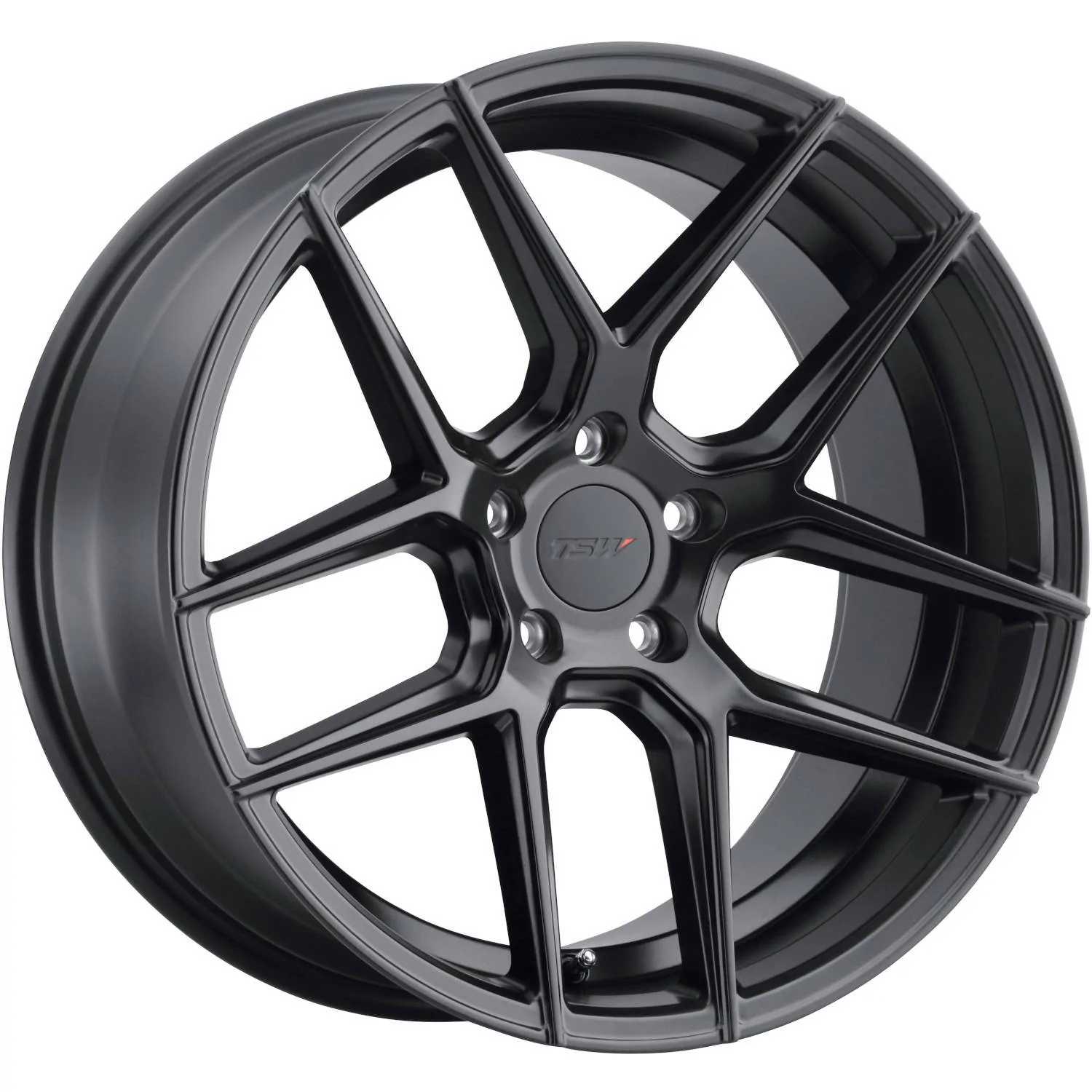

I'm looking to get a square set up with TSW Tabac
It would be 20x10 +25 with 285/35/20 nito nt555 g2
You guys think this would rubb on a 19 gt with stock suspension? is the offset too much?

On 10 inch width the max offset without poke is +30 on the front and +35 on rear, anything more on stock ride height , you’ll have to play with camber to tuck them back in, which is not a good idea, unless you’re willing to sacrifice tire longevity + extra cost on suspension adjustable parts + shortening the wheel bearing life

I just got my wheels in and although we agreed on +30, they are +35 offset. I will be going 285/35/20 all the way around and im sure if I won't rub you definitely wont BUT like he said, def will poke in the back with +25. I would do +30 at the most
