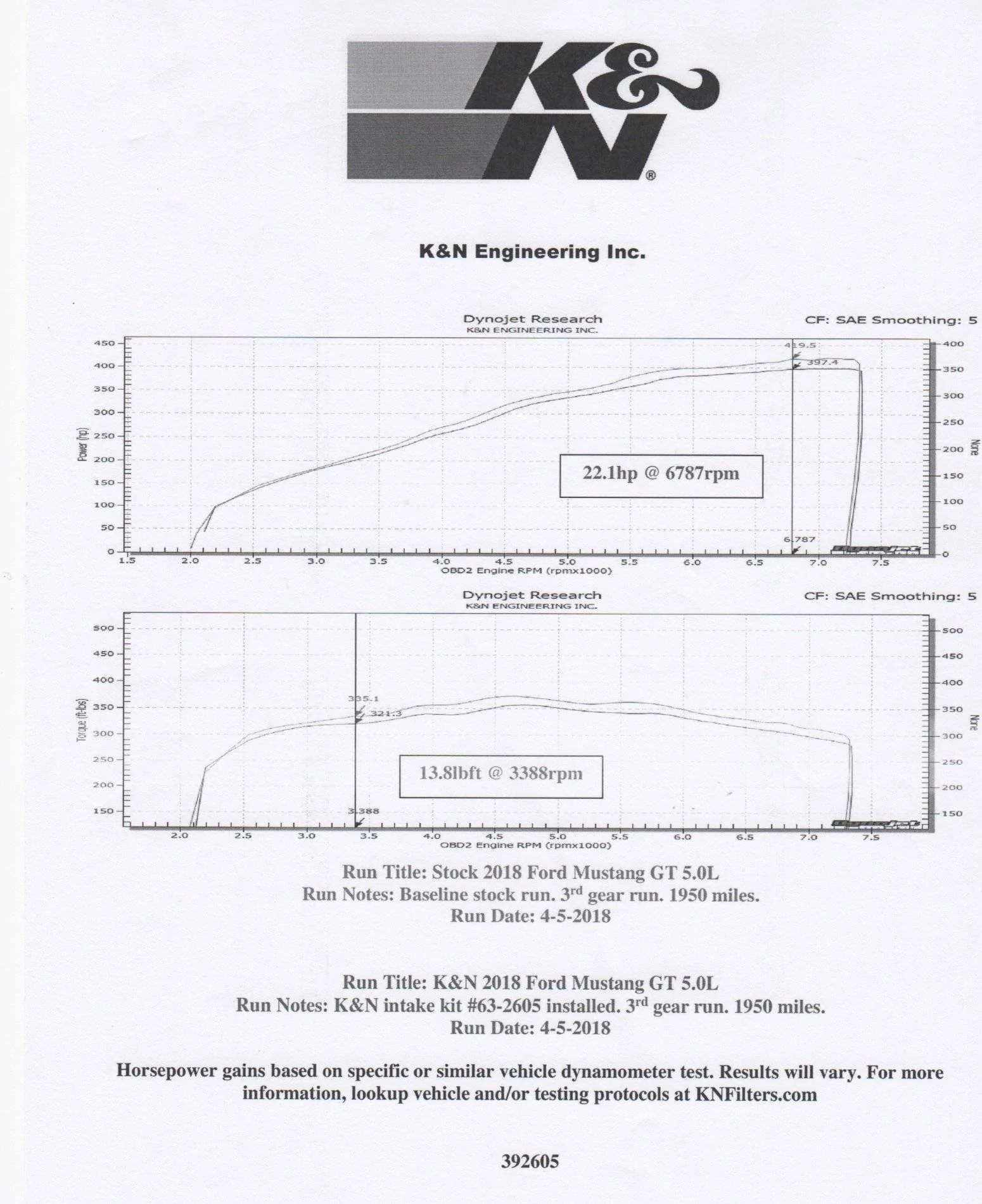

The paperwork I got--

LOL. 22.1HP at 6787 rpm. Come on. While this may be factually correct and keep them from being sued it’s bull. Tell me what the gains are in the 2-4K range where most of your driving is done. Bet it around 5 HP, at best.
