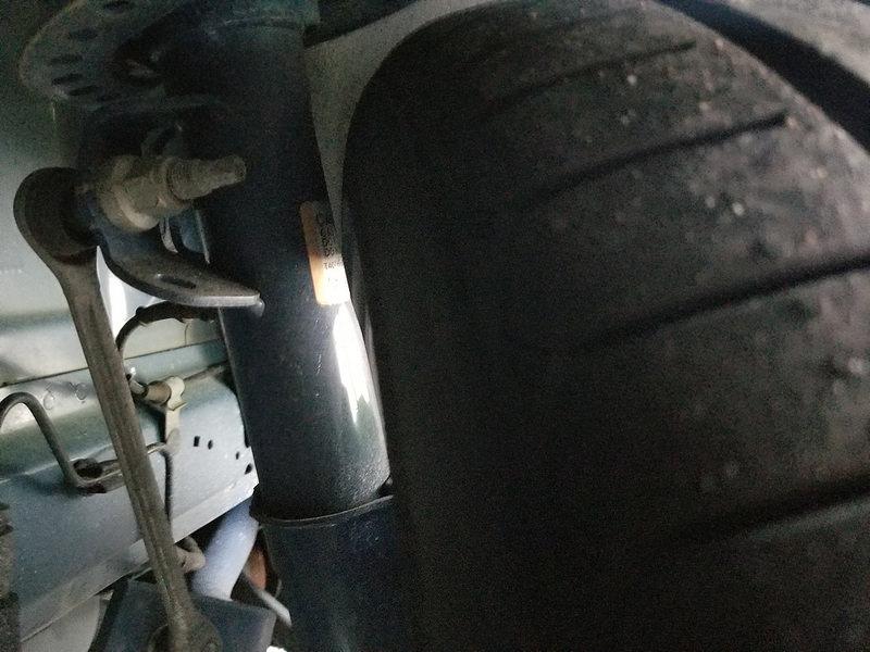

im running 19x10 et40 and 19x11 et55. looks like it could go out another 5mm both front and rear. i'm running 275 front and barely clears the strut. if i wanted to go 285 i'd put a 5mm in the front, so i guess et35.
here's the front with 19x10 with 275s
2017-07-13 19.45.22 by Jae Choi, on Flickr
