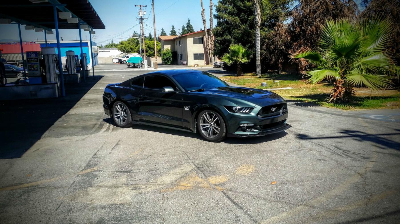

This is what it looks like with the factory 18's lowered on the sportlines. To me the wheels look perfect, just want them to be wider. Thanks for the input on the offset, that answered my question.

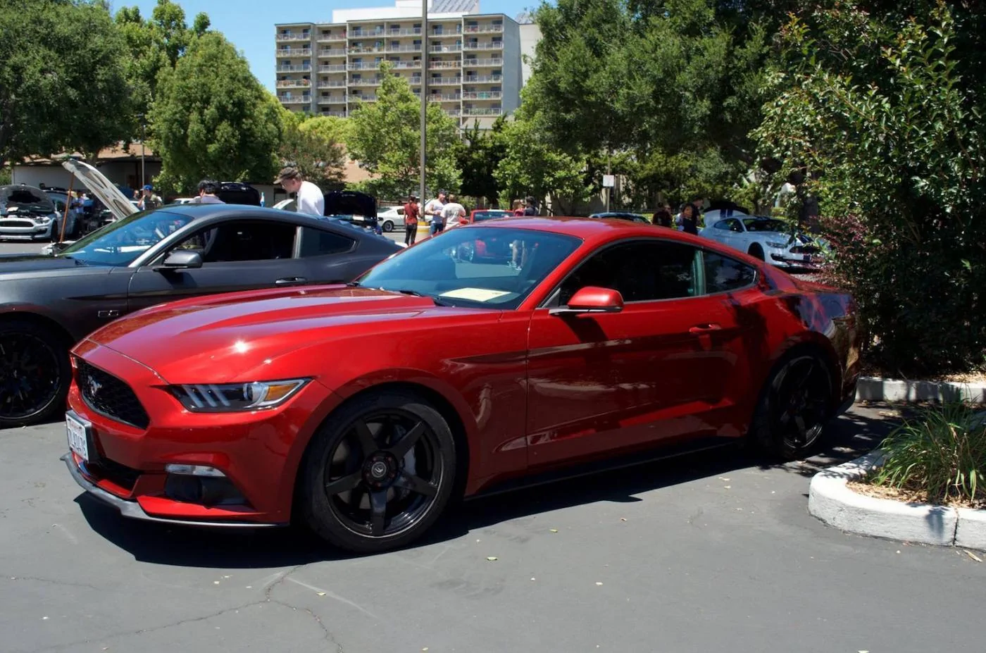

IMO 18's look perfect on the S550. Here's my 18x10 ET40 running 275/40 tires square. Lowered on steeda ultralites.

[MENTION=17119]CrazedAntelope[/MENTION] that looks good! Thanks for the pic, these are the wheels I want to go with to keep a factory look, but still have that 10" tread.
