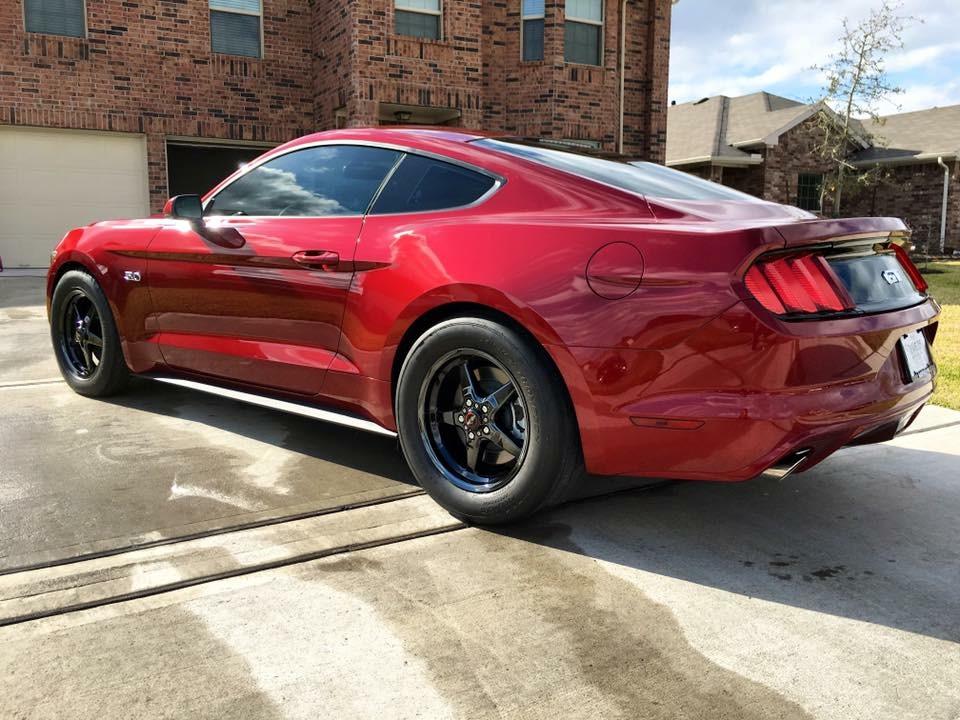

Fair enough on opinions on wheel size, but I'm not overly interested in 20s. I'm looking for meaty tires on a smaller wheel in 18. I don't need to completely full it up, I'd still like to be able to turn and drive without rubbing. I want wide with some meat on the sidewalls, on an 18x10 wheel and not having to lower the car. And yes, c reber, I'm trying to fill it with tire, not wheel.
I love this look, but these are 17" drag wheels and the fronts are skinnies.
