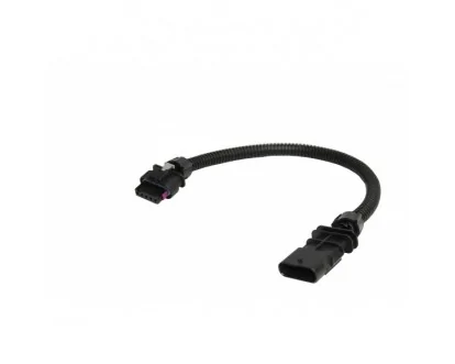

I have had a hard time with this. Pypes has 12" extensions in their kit but that isn't long enough on the A10. It is on the manual trans. Right now I have a 12" on the driver side and (2) 12" extensions on the passenger side. Maybe they will sell them to you separately?

I put the longer O2 sensor (driver side) on the passenger side too so 12” would be perfect

104677 - 12 in.
p/n: 5PIN EXT.
