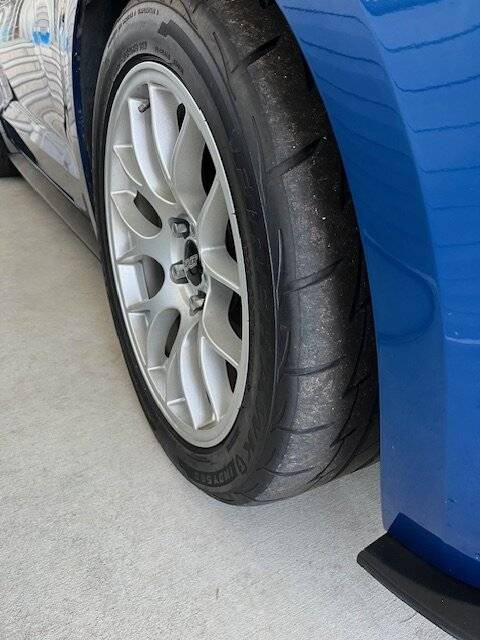

This photo shows the fit of 275/40r18 Firestone Firehawk Indy 500 tires on my Apex EC-7 18"x9" rims (Apex now makes 18"x9.5" rim I don't think they make 9" wide anymore). Good fit, not much if any bulge; and my speedometer reads only 1 mph low at 60 mph: pretty dang close to stock diameter. Firehawks are a great summer tire, 340tw but stick like under 300tw with good wet traction too and wear like a 400tw tire; all while being less expensive than other summer tires. If you consider going this route you'll have a great 18" tire/wheel combo and be very satisfied.
