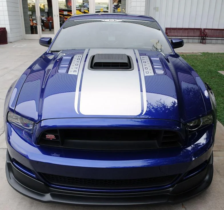

Saw on Fb that CDC has a prototype Shaker set up for the 18+.
They are still working on the final product, I just hope they can allow stock air box use like the older version, but it seems they are limiting this to the tune free pmas cai system. I have heard some feel that pmas system can't work well on the stock tune even they say it doesn't need a tune.
Im not so sure the Gen 3 engine will shake much for the shaker to move?
It seems OK in appearance on a s550.

3 problems I see.
1) The car is so wide it makes the shaker look tiny.
2) The way the hood is designed I feel like unless at very high speeds (100+) the air is likely going OVER the shaker.
2003-04 Mach1 had this issue. The shaker really didn't help much until the top end of the drag strip. Someone tested and it it helped raise MPH and lower ET a small bit. But in general the arch of the hood lead to air going over the shaker at lower speed.
3) Its not really "ramming" the air. its if anything blowing onto the filter from the opposite direction of the stock air tunnel from the bumper with no air box to keep the air in there. It's instantly mixing with the with engine bay air. a JLT or GT350/BULLITT style air-box would help contain the air and also at least help lower IAT temps.

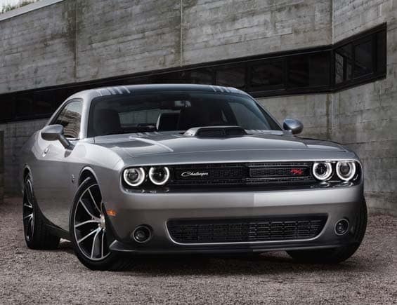

Yeah I can see how a Mach 1 was 73" vs S550 width of 75.4. and if same original size as the 2014 version, 2014 was like 73.9" wide. I can see it is on the small side now, they should have made a brand new larger one, but maybe they are going by the original shaker lid specs. The OEM Challenger Shakers do look better cause it is a retro car, but sometimes at certain angles in person, it looks on the small side on a wide Challenger, but the cuda look shaker is probably a wider lid than the Ford shaker design?

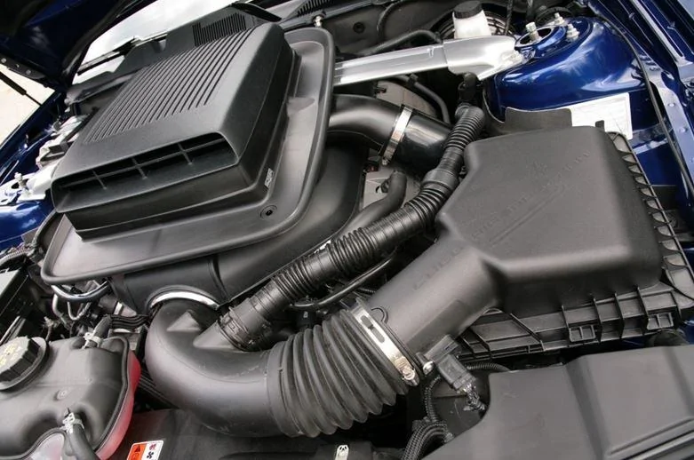

The 2014 kit from CDC does allow for it into the stock air box which is sealed, would that be a better design if not using an open CAI?
To me it would as it insures that you're getting less heat soak and taking more advantage of the cooler air.

But could a sort of pressurization effect cause more issues? The more this is cosmetic, they might as well just make design to just cool the brakes instead :D
