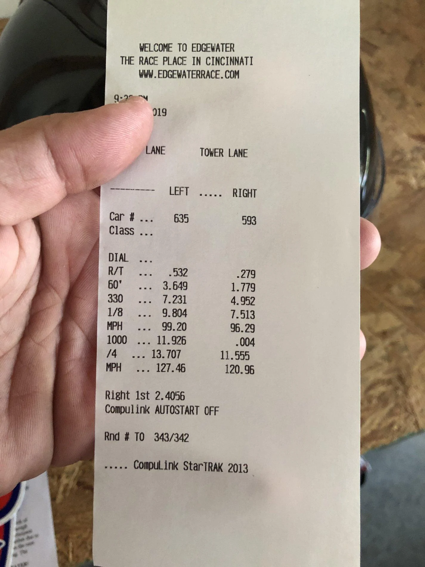

My car is a 2018 Mustang Gt with a JLT cold air intake, long tube headers, Corsa extreme cat-back, tune, E-85, half shafts, Race Star drag pack, and BMR suspension.
My best E.T. of the night was an 11.55, my best trap speed was 122. The DA was 2350 and the car is full weight.
I kinda hoped for an 11.4 but was having a difficult time getting the launch RPM’s high enough prior to starting. I feel like I should have ran an 11.4 but my best 60 foot was a 1.7.

Get that 60 ft down to a 1.5 and your at a 11.1.

Is a 1.5 60 ft feasible with my setup on the foot brake? I would love to get my E.T. down to an 11.1. I know I need to add more revs prior to launching.

I'd say that's a pretty good time for summer. Your sixty isnt bad. You can definitely get a 1.6 sixty on your set up. Even if its only a 1.68-.69. That would have got you your 11.4 you wanted. An 11.1 might be doable this fall when the DA in your area drops down near negative. And you hit that 1.6 sixty. I've seen a 3/10 change in E/T. Just from going from summer to fall DA.

Use the line lock and your 60’ will drop. 18 psi, 2k launch, line lock burnout should get you a high 1.6.

Doing a burnout with my A10 I use the line lock starting in S 1 take to 7K then shift to 2 to 7K, release line lock and drive out of it. At the line put back into D. With your setup you will never do a 1.50 60 foot.

On a foot brake 1.68-65 it’s possible
