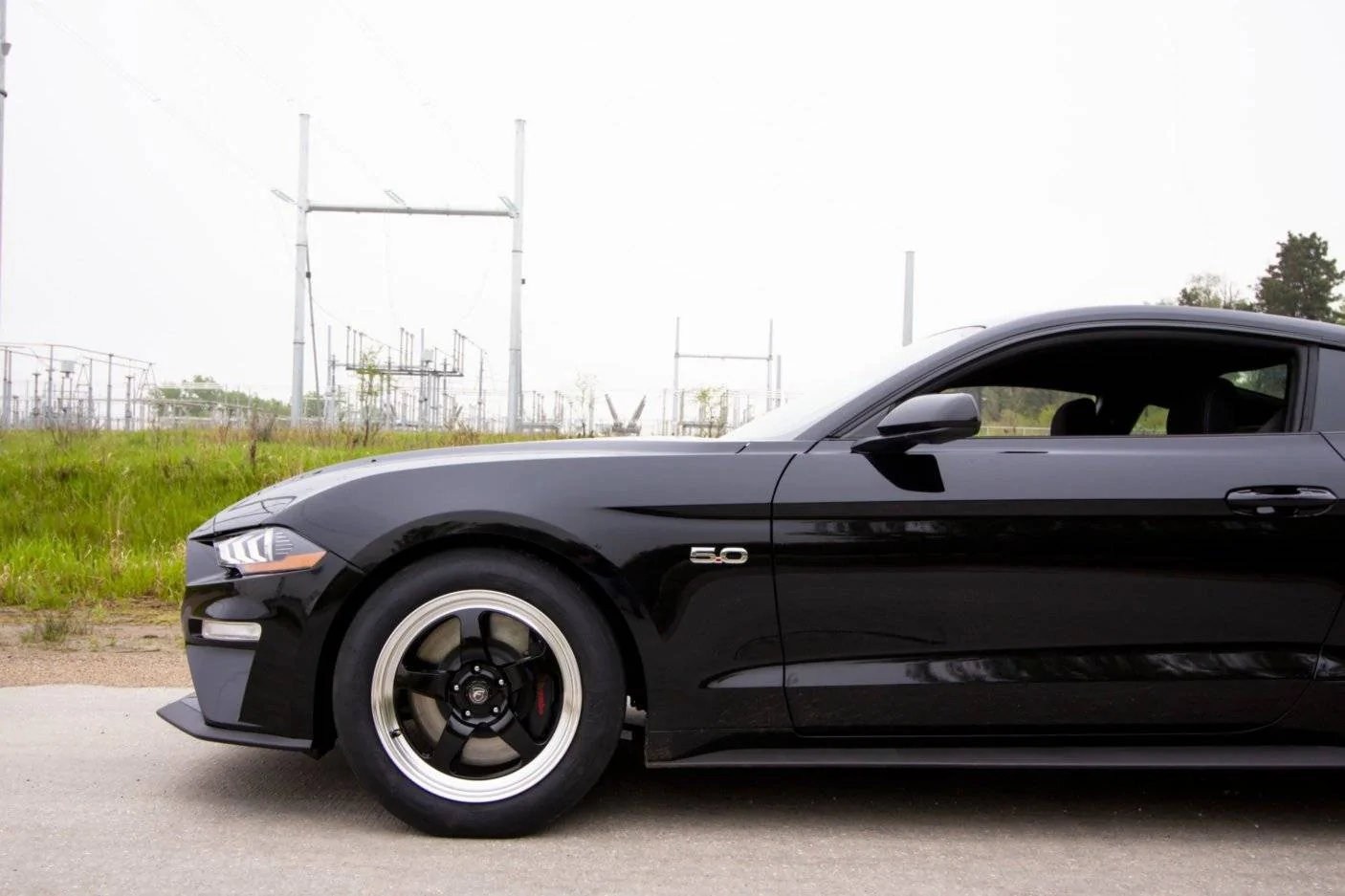

Mine are the 10.5 I believe. Finally cleaned em up n threw em back on for some fun. Maker it look mean.
