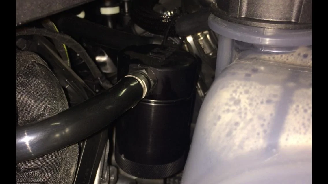

That's the one I got. It's pretty easy to reach up under there and hook it up w/o removing the cover.
FYI, you might watch it after install. Mine was rubbing on the front of the head. You can see the small scuff mark in this pic. I just zip tied it to the hose coming from the coolant overflow tank to hold it out away from the head, and it's been fine ever since.
Thank you for that info. I’ll definitely do something like that up front to prevent that from happening. That’s the only thing I don’t like about the JLT. It just hangs there unsupported. On my 12 GT the JLT lines eventually sagged enough that the unit sat on top of the radiator hose providing ample support.
