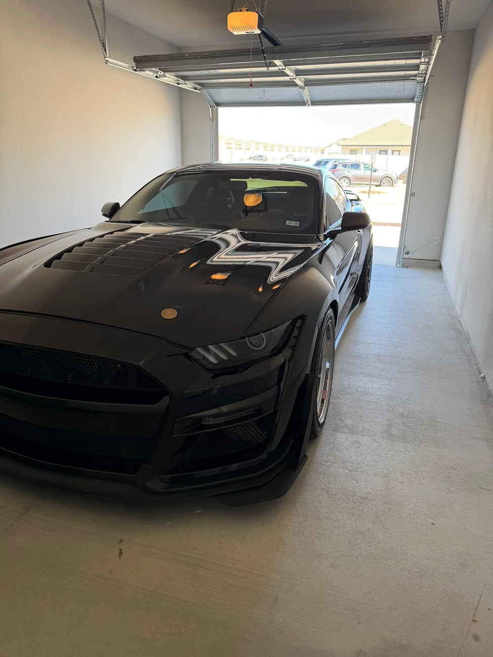

Hey guys,
I’m running into an issue. I’ve got a 2020 Mustang GT and did the I-5 ultimate GT500 front end conversion (essentially an OEM spec gt500 front end). The problem is I had to use 15-17 headlights which are HID on my LED 18+ harness. When it comes to pin out they’re nearly identical except for 2 extra pins on 15-17 headlights. But those don’t show they’re used for power or ground so they shouldn’t matter.
I know it’s possible due to finding a forum on here of a guy that had a 19 and did the OEM GT350 front end conversion and figured out how to get it to work. But when asked how unfortunately he didn’t respond.
I’ve been banging my head trying to get this to work I don’t want to go LED aftermarket since these headlights are full RGB.
So any help would be appreciated!
