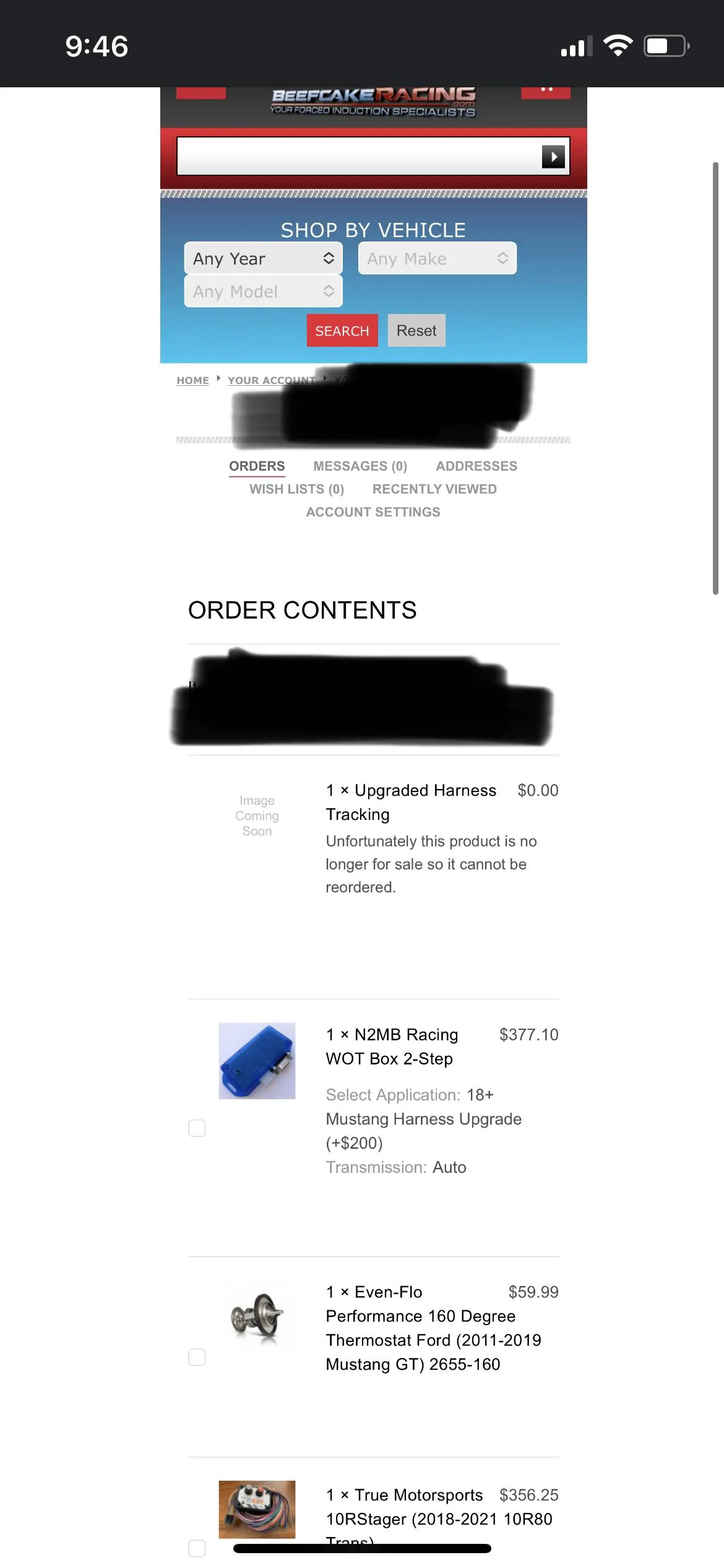

Any special considerations for wiring the 10rstager with the n2mb 2step?
