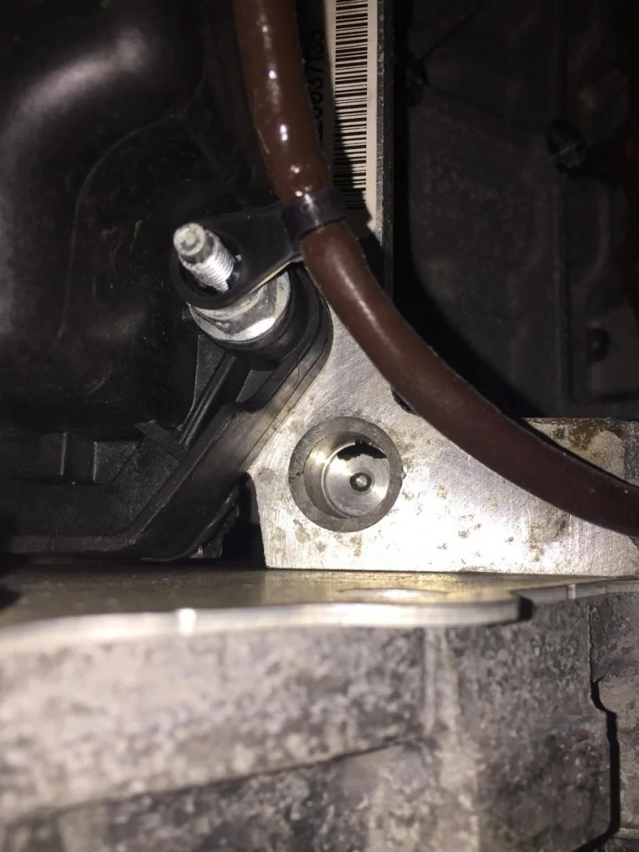

Was the engine bolted to a stand? and was it a specific stand for this engine or a universal stand. I have seen similar issues when engines are rotated on the stand and the improper mounting holes in the block were used.
Some later model engines are supported on the engine mount pads instead of the bell housing area.
I just attached a pictures from Tony Js turbo build and outlined the area I think you are showing and you can see there is not a lot of strength in this area if you hung the engine on a stand and turned it upside down or sideways.
If the crack was at the bolt hole I could see you point. The crack is not at the bolt hole and actually closer to the oil pan.

I'll put it to you it to you this way. The BRAND NEW 25k engine came on an old wooden pallet. Yup! Just laying there. Did the tech install it incorrectly I assure you he did not. Could the engine have been damaged by the tech accidentally? Maybe. Did the engine get damaged during transport? More likely. Is it a casting issue? Strong possibility.

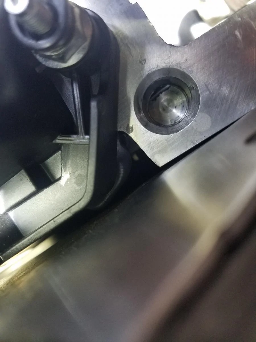

Is the dark spot on the left of the hole dirt or grime or a hole? Does it look similar to the ops pic #2 where the crack originated as far as maybe a casting issue? It looks to be in the identical location as pic #2.
Most of the blocks have that. That is remnants of the casting and could well be where the crack propagated. Will be hard to say as I am sure I will never be told.

Just got my shuttle ride back from the dealer. I took the splitter and belly pan off for them, because, well , you know. I used a paint marker to highlight the area and provided them with the pictures I tool. Spoke with the SM and he said right away that the issue will have to the Regional Service Manager Rep. I happen to know her since I spent two months speaking with her last year over the first engine..DOH! I am pretty certain that the fix will be a motor replacement. That's where the road will come to an end. Really sucks!!!

Just checked mine too as it's on a lift at the dealership. No crack. Interesting though that the hole is drilled to the point of almost going all the way through.
