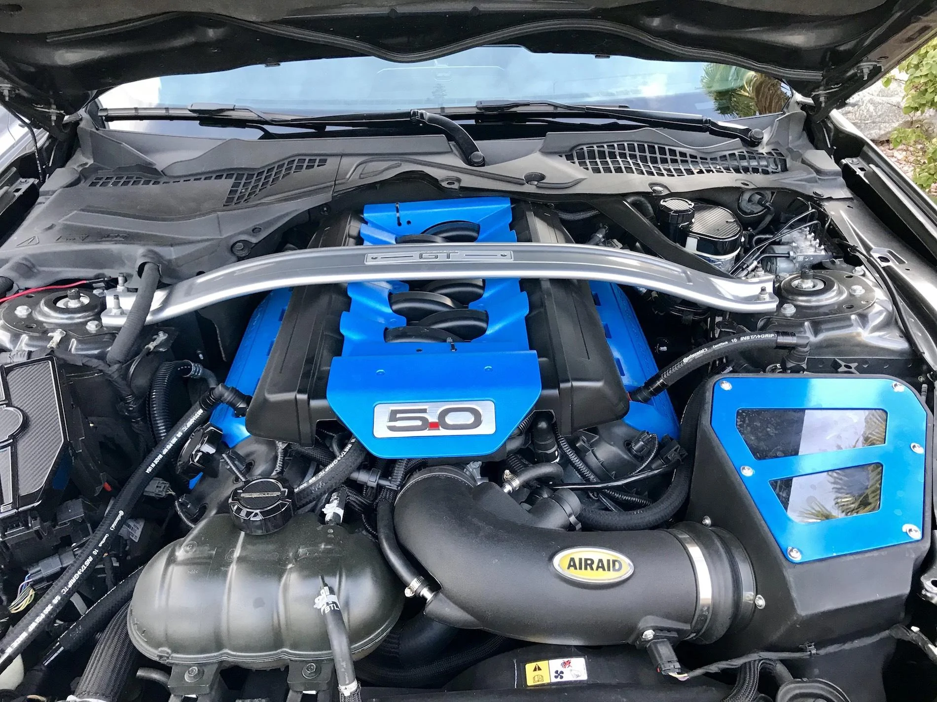

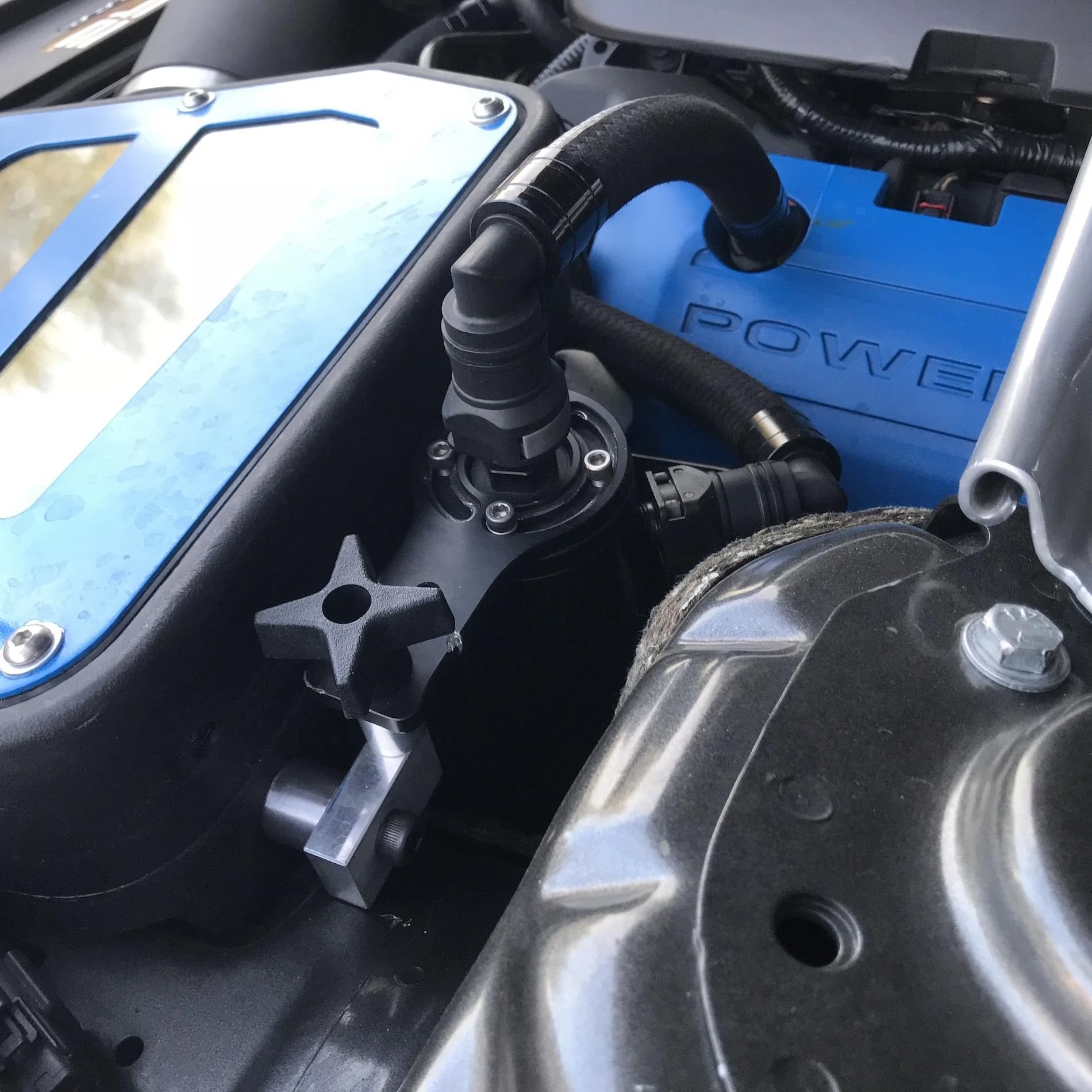

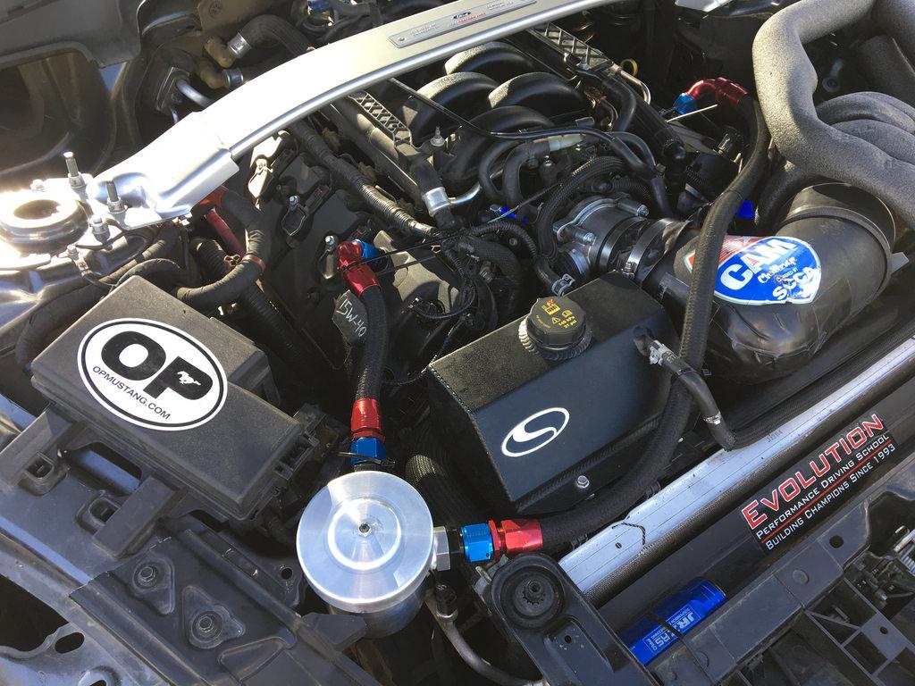

not a PMAS issue exclusively (it’s happened to me on both stock and airraid setups too, dating back to one of my first competitions with the car in 2015), but more so a coyote one. that said i also have a PMAS now, and this issue rears its ugly head like clockwork on any high-g, WOT right handers, increasing in frequency and severity as RPMs climb and oil temps increase. regular catch cans (i.e., separators) are inadequate for severe/sustained effort; i solved it thusly, working closely with [MENTION=25806]SteedaTech[/MENTION] and crew, who also experienced the same problems:

I had this issue like crazy, and I even tired the Watson can but still had oil blow by problems. I went with UPR catch cans on both sides and put a straight through PCV valve on the passenger side and I no longer have any issues!

I do both. For street driving i keep them in loop, and for track use I vent them. I used their stage 3 cans, just ordered two and attached one to each side. Works great!!! Once important thing I did learn that if you vent to atmosphere you need a open PCV valve on the passenger side. You can just order a driver side and put it on the passenger side.
