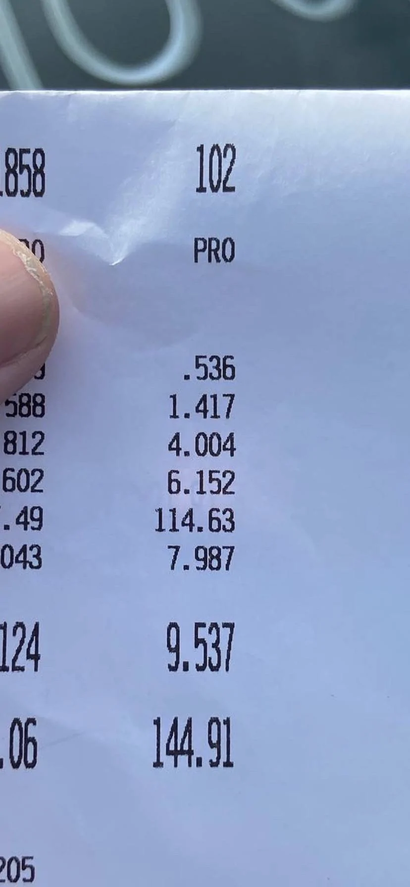

New England Dragway 9/3/2022
10:42am
2016 GT Premium
4010lb race weight
A6/3.15 gear
700 DA
Gen3R, 17psi, E78, 305/45/17 M/T SS’s, front skinnies.

Nice run! The list is updated.

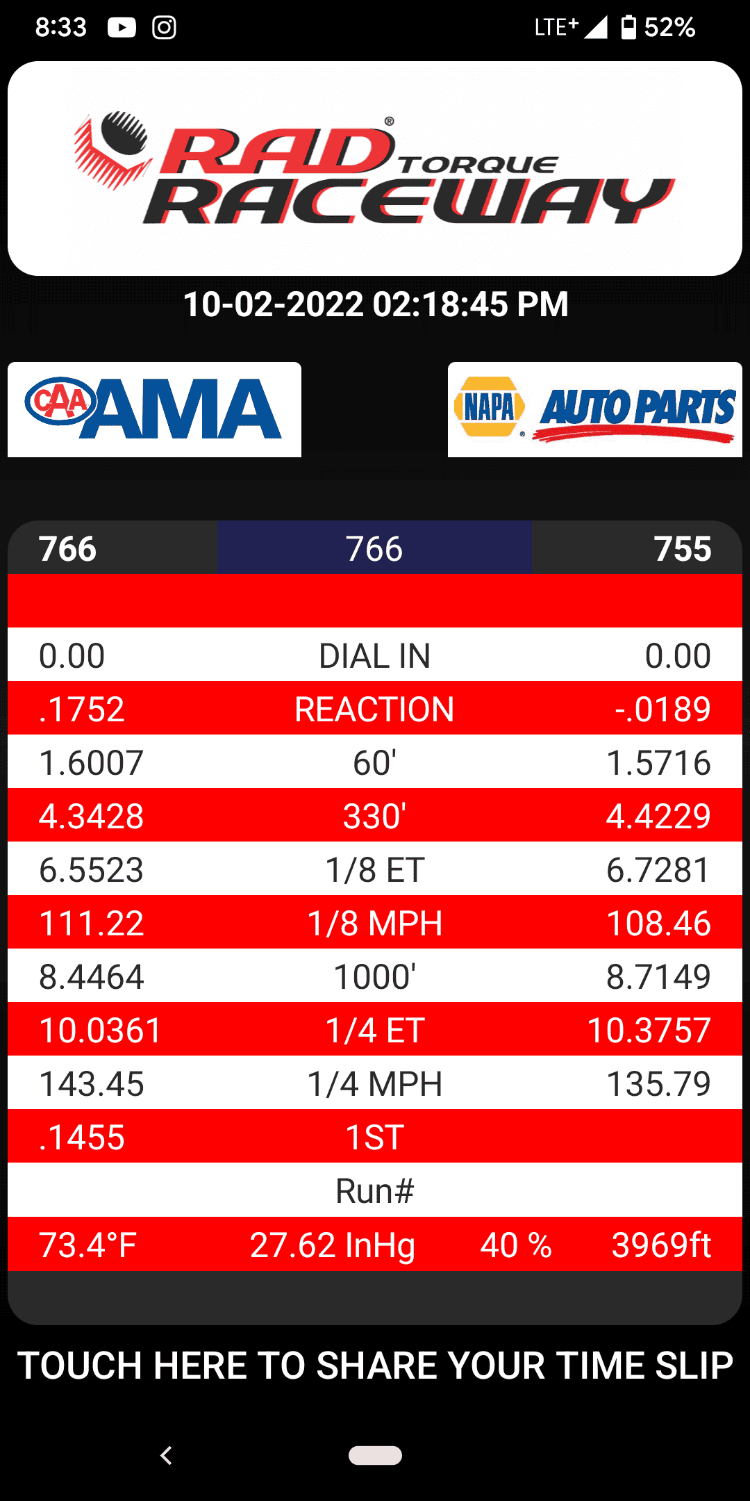

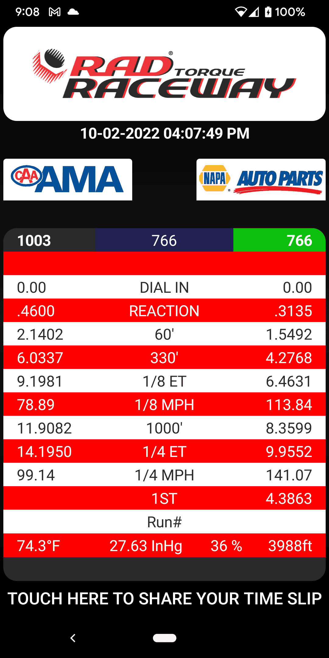

Well I managed a 10.0 at 143 on 3.7 pulley, stock lower and E85 in 4000DA. 10.5-11psi which is my pump gas pulley. I did throw the 3.5 pulley on and picked up 4mph in the 1/8 to 114 but lost a fuel pump around the 1000ft mark and leaned out extremely bad. Still managed a 9.98 at 141 on that pass but lost about 5mph. Here's both slips. Whipple 3.0, full weight 10R car. 4100lbs. 4000DA.

9 second club. Congrats!
Is it hurt?

Thanks! Would have been nice to see the full pass at about 145 but I'll be back. I'm not sure if it's hurt to be honest. Everything does seem ok. Lambda got to .91 and STFT was at 43 percent 😬 but there was no knock or anything. I'm hoping I got lucky...lol

At about what foot mark? If it was near the stripe, it should be ok. It may have went into limp mode at any second anyway. They do a pretty good job at protecting themselves.

Well looking at the log it started failing not long after the 1/8 and slowly was losing fuel the rest of the way. Fuel trims start showing just past the 1/8 and STFT started increasing drastically right to +43 by the 1/4. I was definitely right at the limit. I haven't even tried to diagnose what happened yet or pulled any plugs because I had to go back to work. Tuner believes it's a failed pump or electrical issue. I'm running full fore LV 2 with twin 274's and 1050x

One of the 274’s quit or lost connection. 274’s don’t fail very often. Both trim banks were going lean together right?

Yes that's correct. Both equally lean. +41 on B1 and +43 on B2

Great run and congrats on the 9.x run! Sorry to hear about the fuel pump issue. I hope it didn't damage anything.
Are you running the 3.55 gear?

Thanks and I hope it's ok as well. Seems to be so far. I actually just switched to the 3.31 rear 👍
