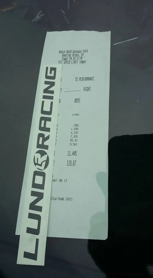

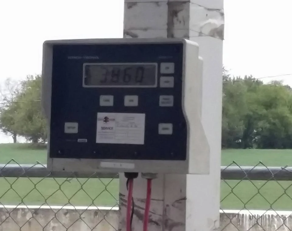

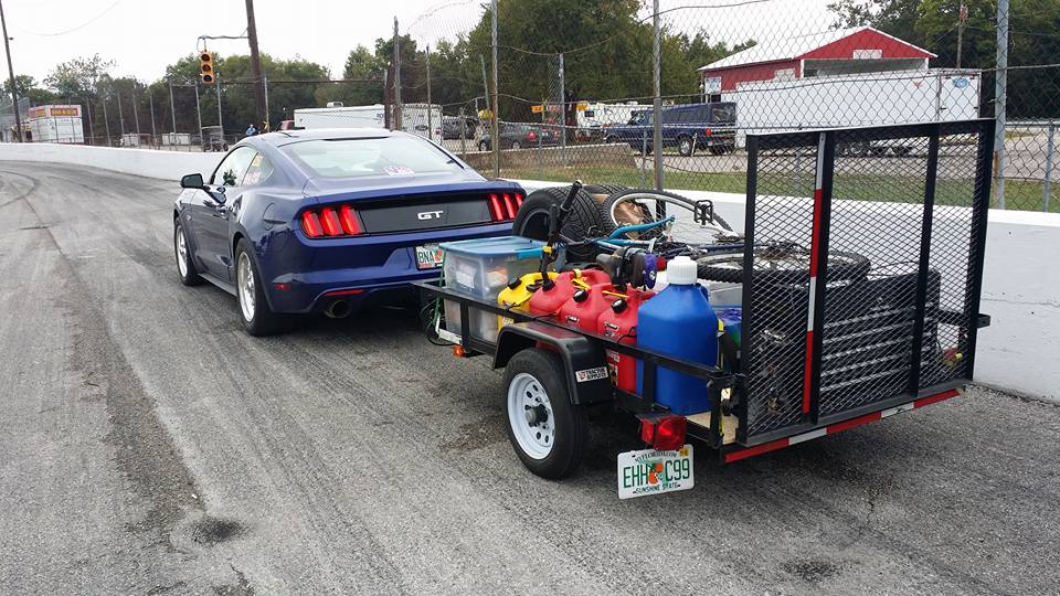

I also came from the Old School experience that the bigger would not benefit such a small N/A engine, but we need to put that thinking aside with the Coyote. I went with 1-7/8" reluctantly, but look at my end results! this car pulls out the back door! And I'm still stuck with 3.15s in an auto at 3,860 lbs! The only combo slower would be if I were a convertible.
