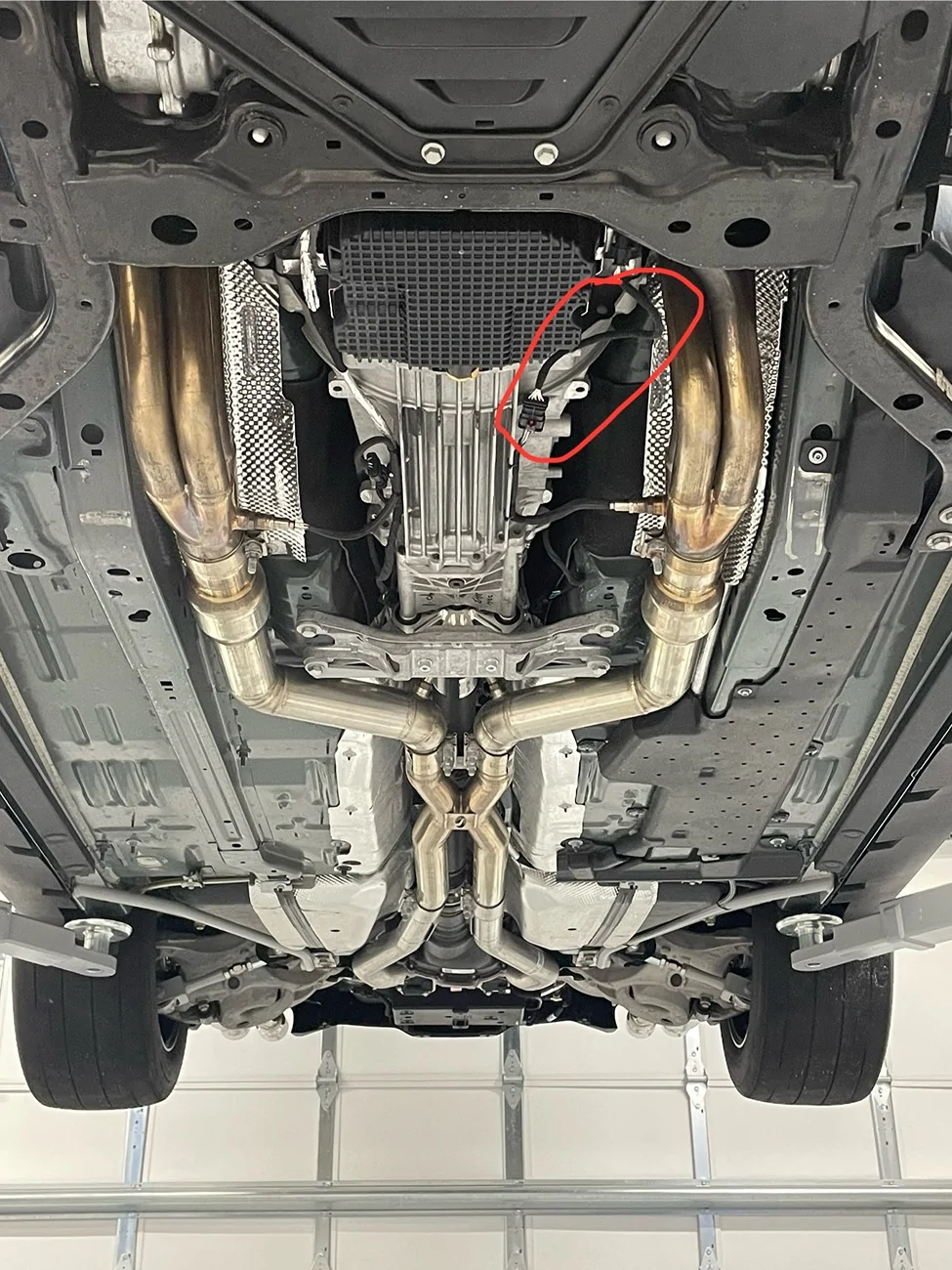

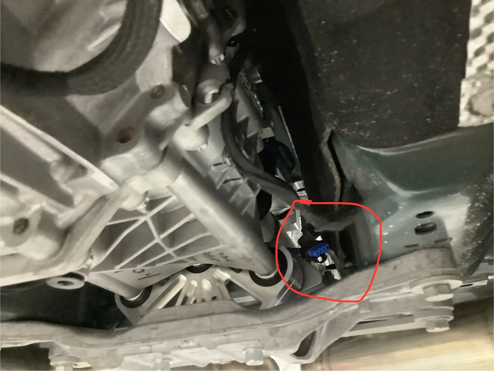

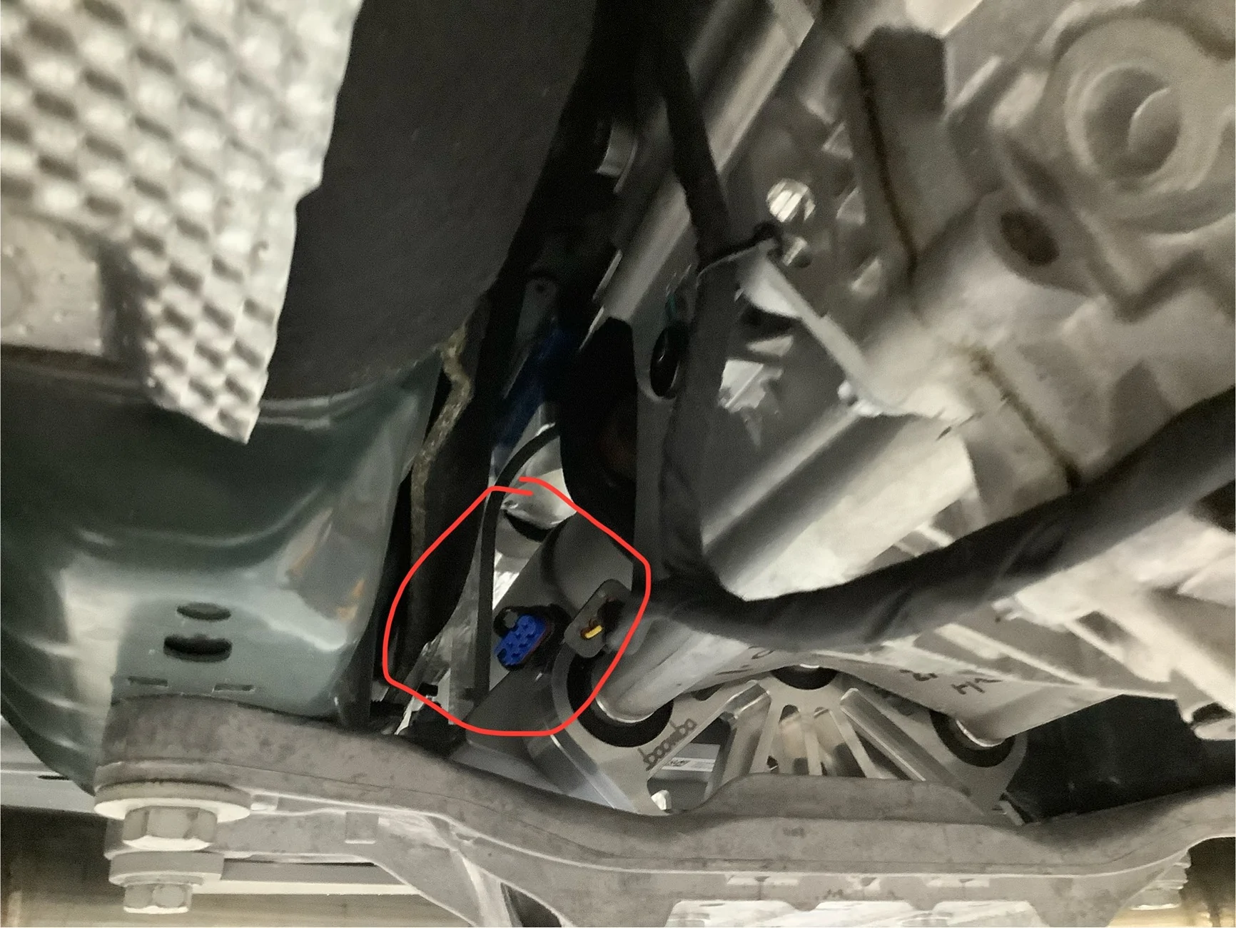

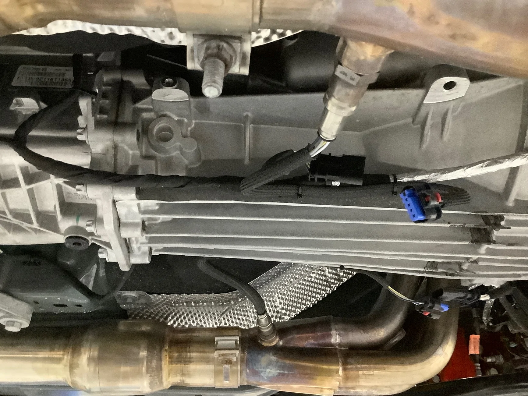

Front o2 sensor plugged into extension harness (circled in red).
Here you can see the rears circles in red.

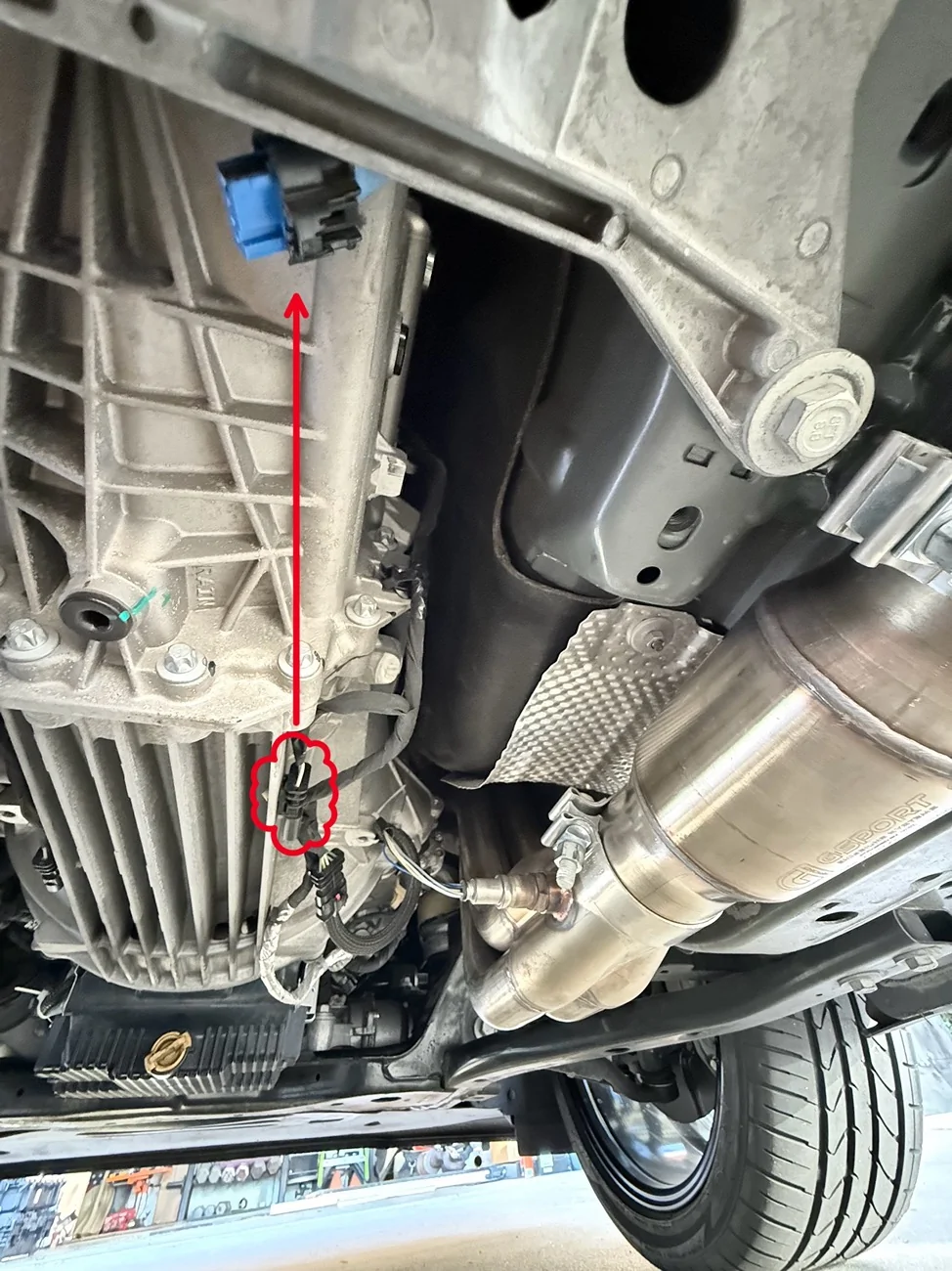

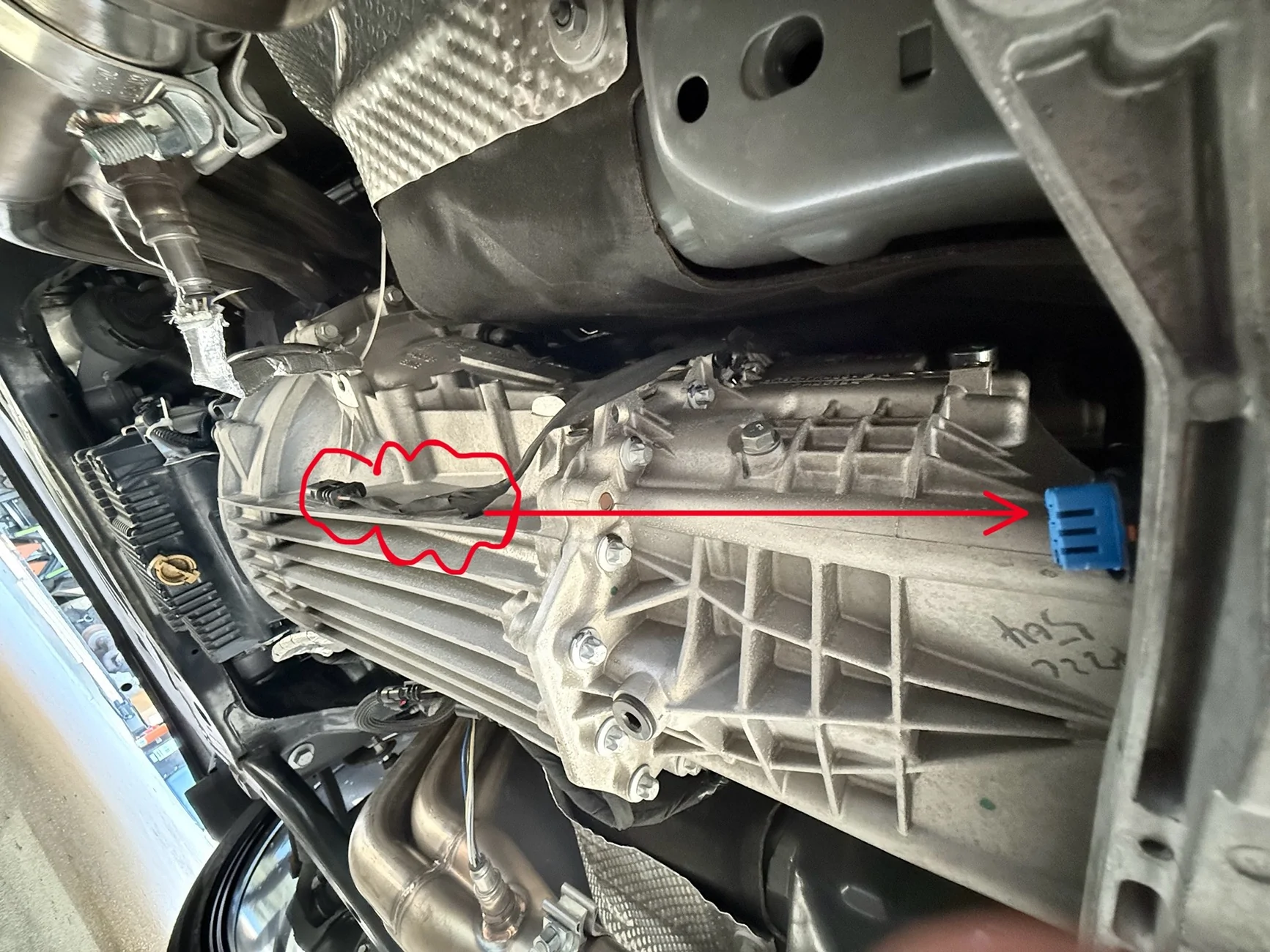

So is this these two here
Sorry, man excuse the stupidity. It’s just these are pointing forward towards the front of the car.
if these are the plugs, obviously I can just pull the push pins from where they are mounted to and set them

The ones in your pic and mine near the transmission crossmember are the rear or mid-pipe sensors. My rear o2 sensors have factory blue heat sleeves on them which is how I distinguish rears from the front. The rear sensors wires are also shorter than the front. I hope that helps.

So then the rears don’t need any extension is that right ? These plugs mounted to the side of the transmission with the push pins in my pics plugged right in to the rear blue o2 sensors

Correct, no extensions on the rears. You’re g2g 👍
