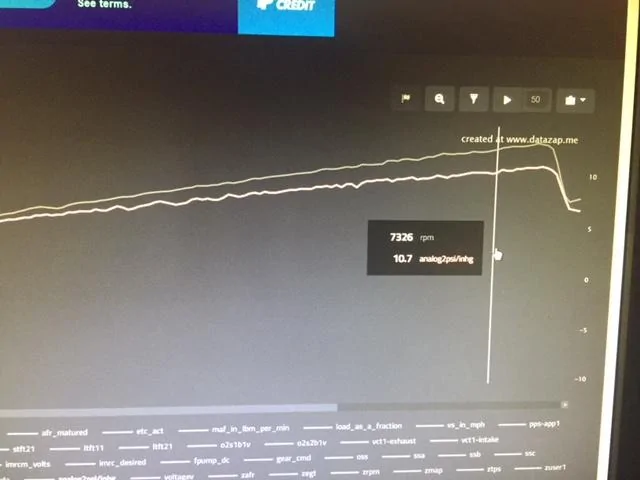

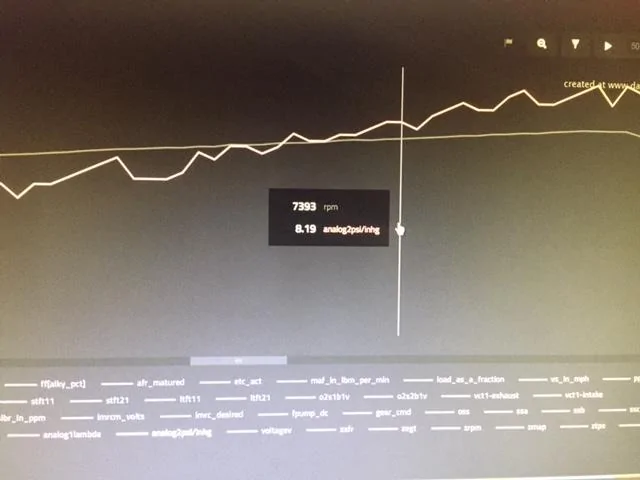

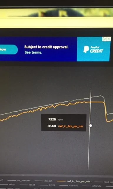

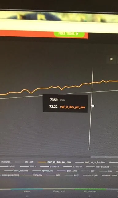

For a long time I’ve been considering making the swap from the Pro flo. Well finally did. There were never any signs of belt slip on the original belt, it was properly tensioned but decided to swap to Gates green belt since a lot of the big boy hellcat owners swear by them. Well results are below...gained 3psi...maf lbs went from low 70s to maxed out. All data taken at around 7300RPM and same ambient temps. Take it how you wish...

Yea u were losing boost somewhere because my d1 has always maxed out the maf sensor with the 4.75 or 4.88 pulley right at 7k.Maybe u were getting belt slip but that's awesome u got it straight now.
