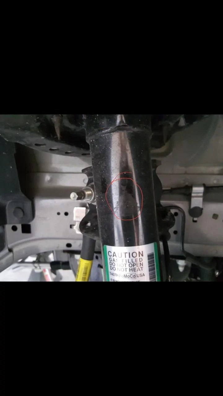

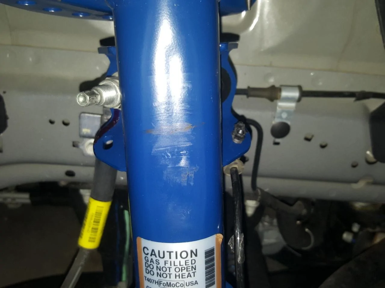

Some of you may remember that I'm attempting to run the MRR 350 Wheels with the 10-inch on the front 305 30-19. I found something interesting I wanted to share with you guys maybe you already knew maybe some of you didn't. Just a recap I ordered one wheel mounted the tire on it put it on my car and it rubs pretty decently against my strut you could turn it but you really had to put some effort into it rubs pretty hard on the strut so I ordered a set of Ford Racing struts to match my Ford racing springs and the first thing I noticed when I pulled them out of the box was right below the spring perch they are a little flat we're my factory struts are round which I was very excited to see because it looks like the same area where I was rubbing and I made a little video to show you the results of that it is still barely touching but I believe with a slight alignment adjustment I will not have to run any sort of a wheel spacer and this is going to work great I tried to take a picture of the flat spot on the strut and for some reason it's just not very noticeable on the pictures but I thought you guys might find that interesting and understand that by running the Ford Racing strut you can run a wider Tire ill post a pic of the factory struts and the ford racing strut you see a larger smudge and a very thin smudge with the new strut. Here is a link to the video https://drive.google.com/file/d/0B_P5MTOdRcd4cWd3dXJQazdoR0U/view?usp=drivesdk

Lol, my performance pack struts had the flat in there to begin with. Maybe that isn't the case on the standard struts?
That's cool. The regular GT struts are round

The 295/30/19 I’m running almost touched. The little hairs touch the. the 305 30-19 that I'm running rubbed hard after replacing the factory struts with the Ford Racing strut right below the spring perch they are flattened a little bit which made all the difference in the world and it was still barely touching I posted a little video of how free it was spinning but still ever so barely touching and what made the difference was the Steeda camber bolts which actually will move the strut slightly away from the wheel and I was able to get my alignment back to OEM spec and the tires are not rubbing now they do rub just a little lock to lock so I can't turn it all the way but they do not touch the struts anymore as soon as I get my last wheel I'll post a thread on how they look. I have a little video of the clearance that they have now I'll try to get that posted
