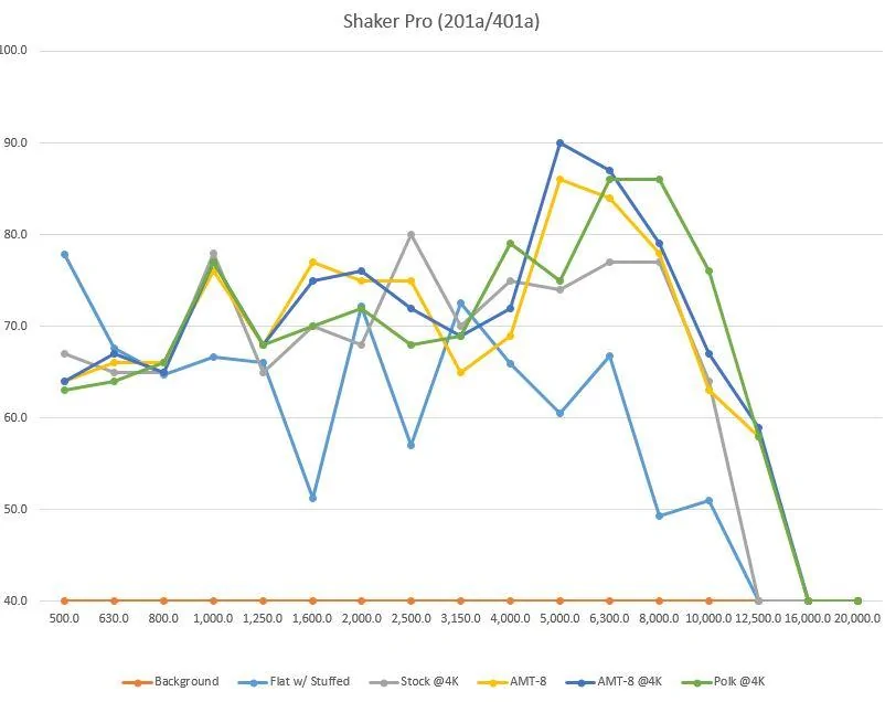

So far we have:
Stock 8 Ohm - Meh
AMT 8 Ohm, no crossover
AMT 8 Ohm, Polk 4K crossover
Polk 4 Ohm, Polk 4K crossover
It's way too early to pick one, since 2 more sets arrive this week. Besides, they're tweeters, arguably the most personal of all speakers. So many choices...
Adding a chart tomorrow, sadly it will probably make things worse... :eek:
It is the Focal Test CD plotted by weighted peak db for each frequency.
See this.

EcoBOSS
Oct 10, 2014
240
48
Tejas!
2015 EcoBoost Premium, PP, 50th, RR
Yeah, about that...
And the fact that Ford pointed the tweeters at each other...
Settings: Left side front only, Bass/Mids/Treble to "0"
Tools: Focal Test CD, Radio Shack 33-2055 Digital Sound Level Meter. MS Excel
See the color coded labels at the bottom of the graph:
Gold - Background - this is our db floor (39db actually) - listed as 40db for simplification
Light Blue - Stock, no crossover, subwoofer stuffed with Poly-Fil
Gray - Stock with 4K Polk crossover on factory tweeter
Gold - Dayton AMT-8 tweeters (direct)
Dark Blue - Dayton AMT-8 tweeters with 4K Polk crossover
Green - Polk db1001 with Polk crossover
First, compare Light Blue and Gray - this is JUST with the addition of the crossover (-12db 2nd Order) that shows that even the stock tweeters can benefit from a quality crossover - but don't bother, they fall flat on their face at 10K. Notice how the "curve" is affected all the way down to 500Hz - this is due to the crazy impedance issues with multiple speakers discussed earlier.
Next is Gold and Dark Blue shows the benefit of a crossover on the AMT-8 and the extended highs (12,500Hz). This tweeter would be GREAT for a "no fuss" drop-in for someone keeping the 8 Ohm set up if you listen to acoustic, classical and such. That 5-6K peak makes for some incredible "presence" in acoustic guitar and other strings. Off-axis volume is tricky, but it is livable. Total "stealth" install.
Finally the Green - Polk w/ the Polk 4K Crossover, install is going to be MORE involved (remove factory grille and some grinding), the cover has logos and is gray and black - not a "stealth" install at all. Extended 6.3K to 10K output has better definition all around - great of any music, but you MAY have to snip the -3db yellow wire on the crossover. I had to reduce my Treble from +3 to -3!
What does this mean? You need tweeters, they suck.
Find something nice in 4 Ohm and make sure it has more than a -3db 4.7uF cap for a "crossover".
Polk db351's and Crossover parts arrive this week - going to see what a "High Pass" crossover does for these result...
