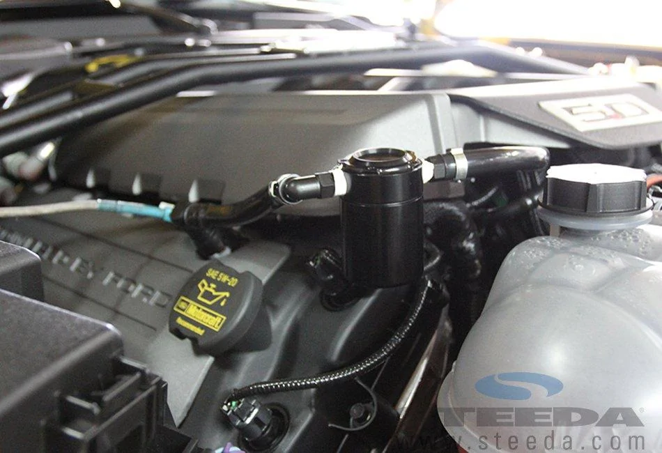

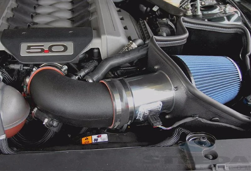

OR we hold the Steeda spring range and Steeda sway bars in stock in the UK too. :):thumbsup:
[MENTION=22385]Steeda UK[/MENTION] Do you sell the OEM GT350 air intake and the driver and passenger side FP oil separators, you would then sell everything I need ?

Are these all the parts I need to recreate the Ford Power Pack 3 ?
M-6766-A50S - Ford Performance Oil-Air Separator (15-17 GT350, GT350R)
M-6766-A50 - Ford Performance 5.0L Coyote Engine Oil-Air Separator
M-9424-M52 - Ford Performance Mustang GT350 Manifold - 5.2L Coyote Intake
M-9926-M52 - Ford Performance Mustang GT350 Throttle Body 87MM
FR3Z-9600-E - Ford Mustang GT350 Cold Air Intake Assembly
