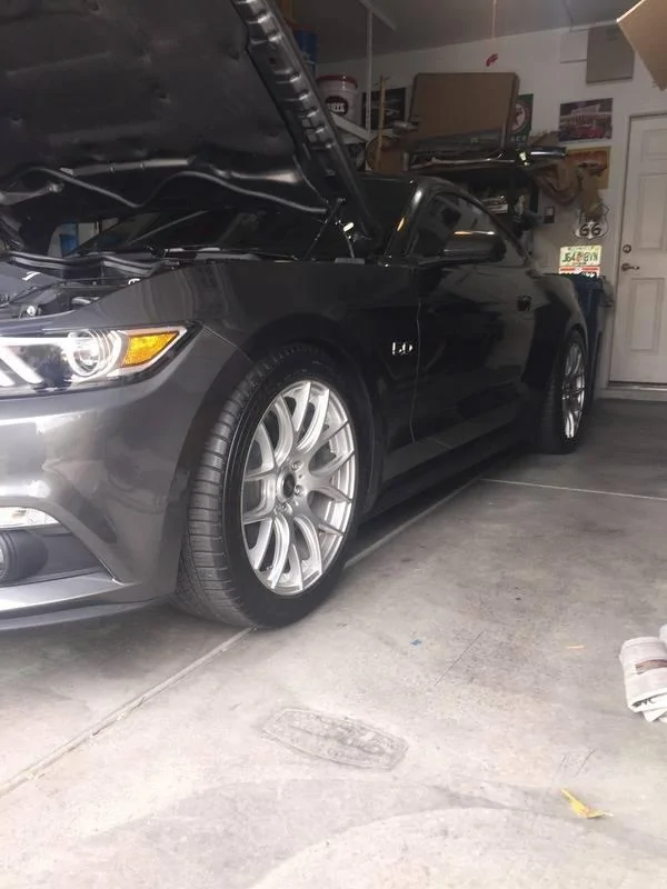

I ordered some BMR SP080 springs along with their camber/caster plates back in October and finally got around to installing them last week. I'm very happy. Looks/handles great and ride quality did not suffer at all.
The place I had the alignment done had a hard time aligning it, but it was their lack of experience with camber/caster plates on their end. I want to give a huge thank you to Kelly at BMR for talking the alignment tech through the adjustments. The alignment place kept telling me that I needed camber bolts to get the adjustment I needed. No, I didn't. They were even telling me that I installed the camber/caster plates on the wrong side and were only convinced that they were installed right after they removed a strut. Oh well, it's all good now.
I also ordered some painted coil covers and plenum cover from RPI Designs in October and they finally arrived yesterday. All in all, I'm happy with how everything turned out.
Here are some horrible pics I shot. I'll get some better ones on a sunny day.

Wow, thank you Dave for the post!
I am happy to know that you like our components, and that we were able to get everything dialed in. Sometimes, those alignment shops simply need to talk to the companies who make the products, as they are typically performing high volume "toe-and go" jobs on OE equipped vehicles.
Thanks again! BMR FTW!

Pictures look good to me. . .nice upgrade
