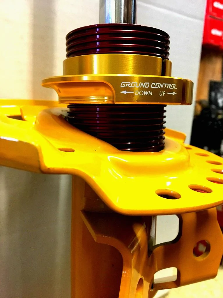

Ground Control S550 Adjustable Right Height Kit
Ground Control Systems is now offering our Adjustable Ride Height Kit for the S550 chassis. This system is designed to work with your stock struts/shocks, as well as most aftermarket dampers. Using custom linear springs, we can include rates to match whatever type of driving you plan to use the car for, modifications already done to suspension, and the different weights of the S550 drivetrain options. Custom spring hats are included to work with OEM upper strut mounts, and camber plates can also be included at a "package" price. Expected ride height adjustment range is stock to -2 inches.
Item in link below.
http://www.ground-control-store.com/products/description.php/II=993

Looking at the picture, it appears that you would not have to modify the strut to use this.
Actually no. Unless I am missing something there should be ZERO modification of front struts. What are you seeing that I am not? :shrug:
I did say 'not' ;)
Correct. You do not have to modify the strut in order to install threaded sleeves. However, we do offer the option if you would like to remove the OE size spring perch. The option to remove the spring perch will get you further adjustment if you wish to go lower. However, this system can include many different front spring lengths to get you to your desired ride height.
