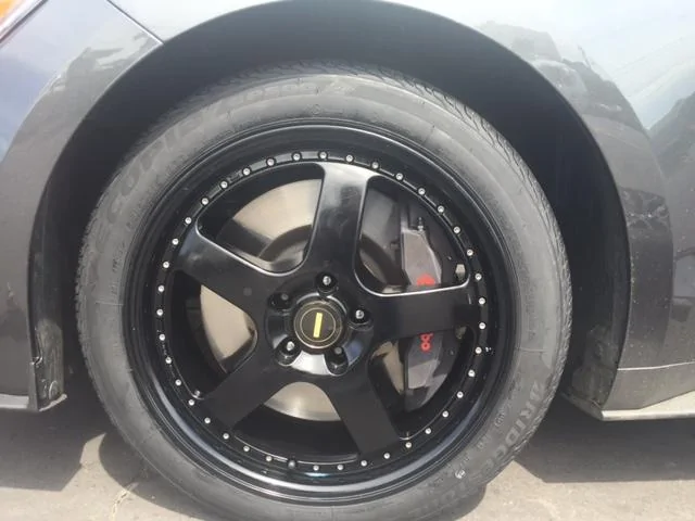

Simmons do a 19 x 7.0 ET + 20 that they think will fit over the Brembos, I am organising a test fit with them. There is a 175/60 R19 tyre available from JAX tyres that should fit this rim.
Diameter of the tyre is 693mm compared to 703mm on the standard rear tyre, this equates to 740 revs per mile compared to 730 revs per mile on the standard one.
I have asked my dealer to fire off an email internally to Ford to get confirmation from them on what speed and distance limitations they would place on using wheels with this sort of diameter difference.
Quote “Gnome”-
Yes the plan is that it will work on the front and the rear. Ideally I was after a 6.0 or 6.5 rim, but the 7.0 may also just fit the depth

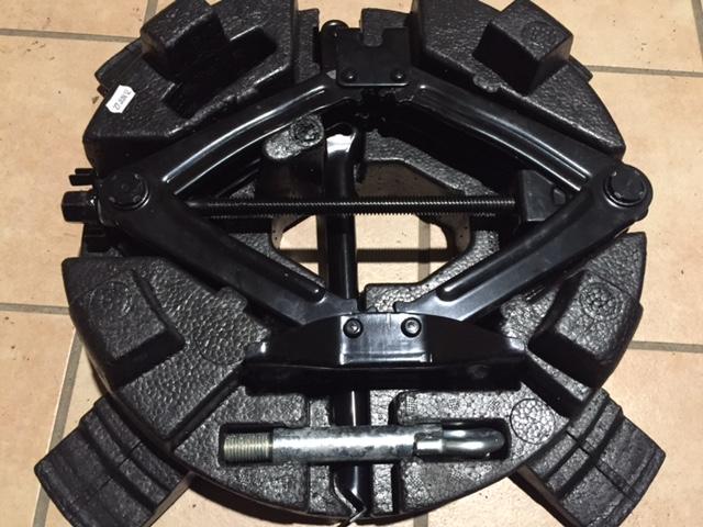

The next step is to purchase from a car wrecker a “Falcon FG” jack kit. Make sure you not only get the jack but also the foam base and all other components. Expect to pay somewhere from $50 > $100

Place the complete Falcon FG jack kit / foam base in the wheel well making sure to fit the towing / recovery bolt from the original Mustang compressor kit into the FG Falcon foam jack kit base.

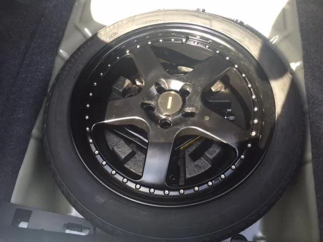

Place the spare wheel in the wheel well, at this point you may need to trim some of the Falcon FG jack foam base to ensure that the spare wheel fits snug and does not protrude higher than needed.

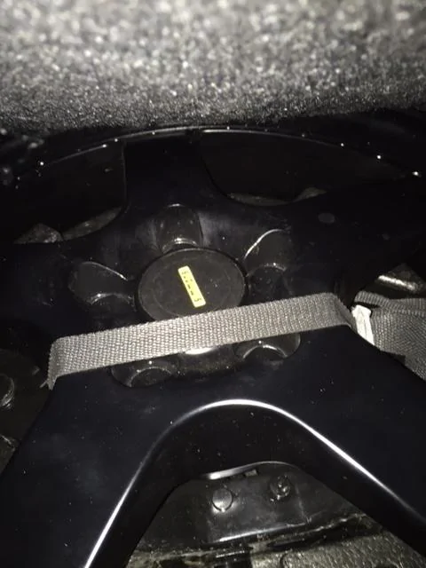

Pass the nylon tie down strap underneath the original bracket which secured the compressor kit, then up and over the spare wheel spoke, tighten the strap until firm.

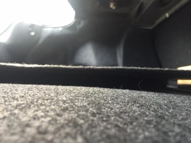

The Gnome spare sits a little higher in the wheel well making the rear spare wheel cover sit approx 10mm proud from the floor surface when closed. The easiest solution is either a rubber or carpet trunk mat which smooths out the imperfections creating an even look.
