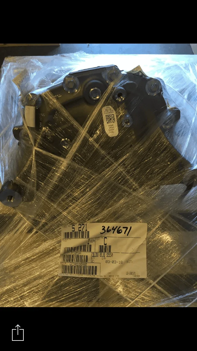

If you need to order a pumpkin here's the part # for the one with 3.31s.
