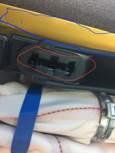

I tried fixing this rattle, but you can still somewhat hear it on rough pavement. I put sticky felt on all the clips. Also, I put gorilla tape on both sides of the piece that is part of the tether clip (circled in red). Also, I put felt in-between the black plastic and the metal body (circled in blue). So while on the freeway it was rattling and I put pressure on the c-pillar and it stopped. The location of the pressure point was where the tether clip base is located on the inside. So is there something that I didn't insulate. When I tap on the pillar it makes a hollow sound in this region. While the driver side c-pillar doesn't make this hollow sound when you tap on it. Could the tether clip be banging against in the plastic?

I did this but it didn't really help.
In this pic, did you really wrap velcro strap around the air bag? :shrug:

It's helped some for me, but now I'm chasing down other rattles. Seriously, Ford, WTF.
And, no, I didn't velcro-wrap the airbags. The dealer actually did that.
