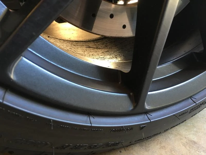

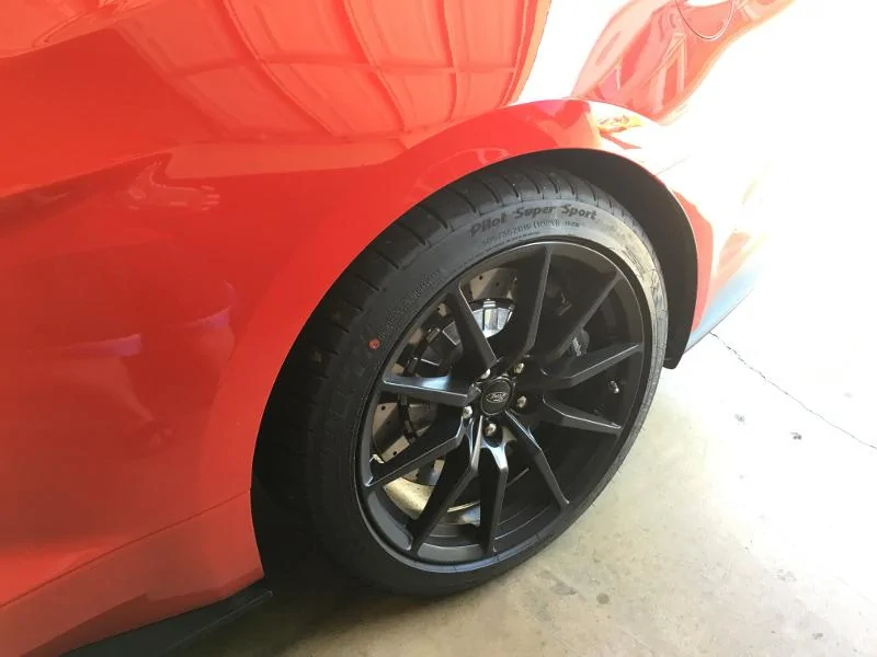

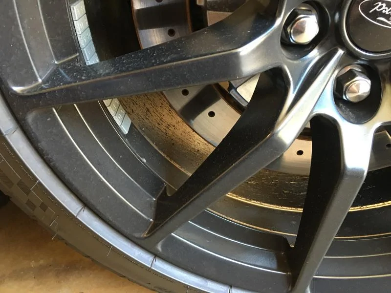

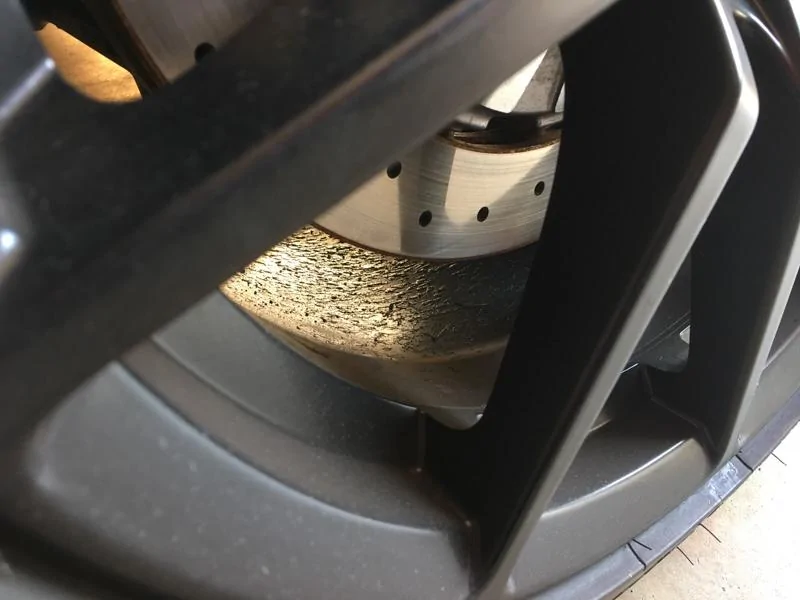

I didn't do a great job checking over the car when I picked it up. I found what I thought was a great deal and jumped on it before it was gone (had previously missed out on a blue 16' closer to me @ MSRP). Among the issues I found the next day was my rear driver's side wheel has a coating of grease over the entire barrel of the wheel (that now has brake dust and dirt mixed in).
What's the deal with that? Do I need to take any special care in cleaning it all off?

I would take the wheel off and thoroughly clean the inside with some wheel cleaner. While the wheel is off, also visually inspect for any issues with the diff or axle. If you are not comfortable with this, take it to the dealer and have them do it. I would be more concerned with the origin of the grease than the cleaning element though.

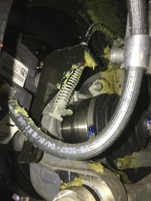

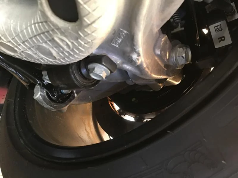

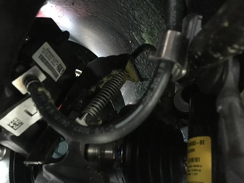

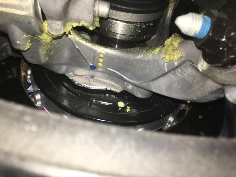

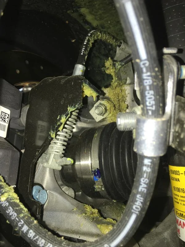

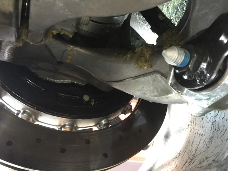

I haven't gone to the dealer yet but I did get some better pictures. I'm going to try to take it in tomorrow morning just to have it documented in the service history.
The last picture is of the right side for comparison.

that...is not normal
AutoX_GT
Aug 10, 2015
186
51
Columbus, OH
2015 Mustang GT Performance Pack - Black
Yeah that definitely has to be a tear in the outer CV boot of the half shaft. Easy fix though..
