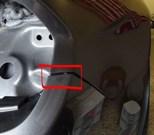

@ Montreal- is there a tab or clip in this section? When I look through the gap on mine there appears to be a tab or clip not engaged. But, Id say mine is at a 3mm margin in the boxed section but is even RH to LH so I haven't gone any further with it.

How did you align the fender and bumper when u pulled the liner out? I tried but couldn't figure it out.
Did you pull the wheel well plastic shield ? That is step #1.
Once that is out of the way, look inside the wheel well on the right where the fender meets the bumper, there is an attachment block that holds the fender and bumper together. Just above it you'll see a single screw sitting vertically.
It is a bit hard to get to it, but i was able to get s small wratchet and remove it since it was stripped and i replaced it with a bigger one and re-tighten it and that fixed the gap.
Myshelby3425
Aug 27, 2015
77
2,170
555
Miami
2018 GT
Yea I got this far. Mine has the gap filled it's just not aligned with the fender. Bumper sticks a little further out and does line up flush to the fender.
