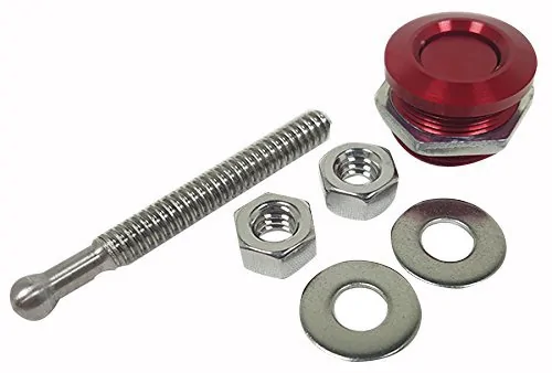

Resurrecting a dead thread here, but I just had my tabs break yesterday when autocrossing. The RH side was sticking out for some unknown reason before I ever ran, and I just popped it back in. Then later I absolutely murdered a couple cones, and when I got back to grid I noticed the LH side was completely goobered up with the tabs broken.
Then last night there was someone on a Mustang facebook page that installed Quick-Latches to hold the grill in place. I would link her post but I don't want to without her permission. It ended up looking pretty good on her car, so I am going to go that route, with red anodized latches. Part number is QL-25-RD22.
If she gives me permission, I'll post pics of them installed on her car...
