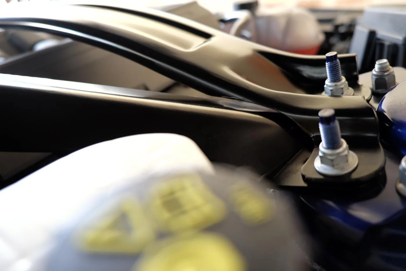

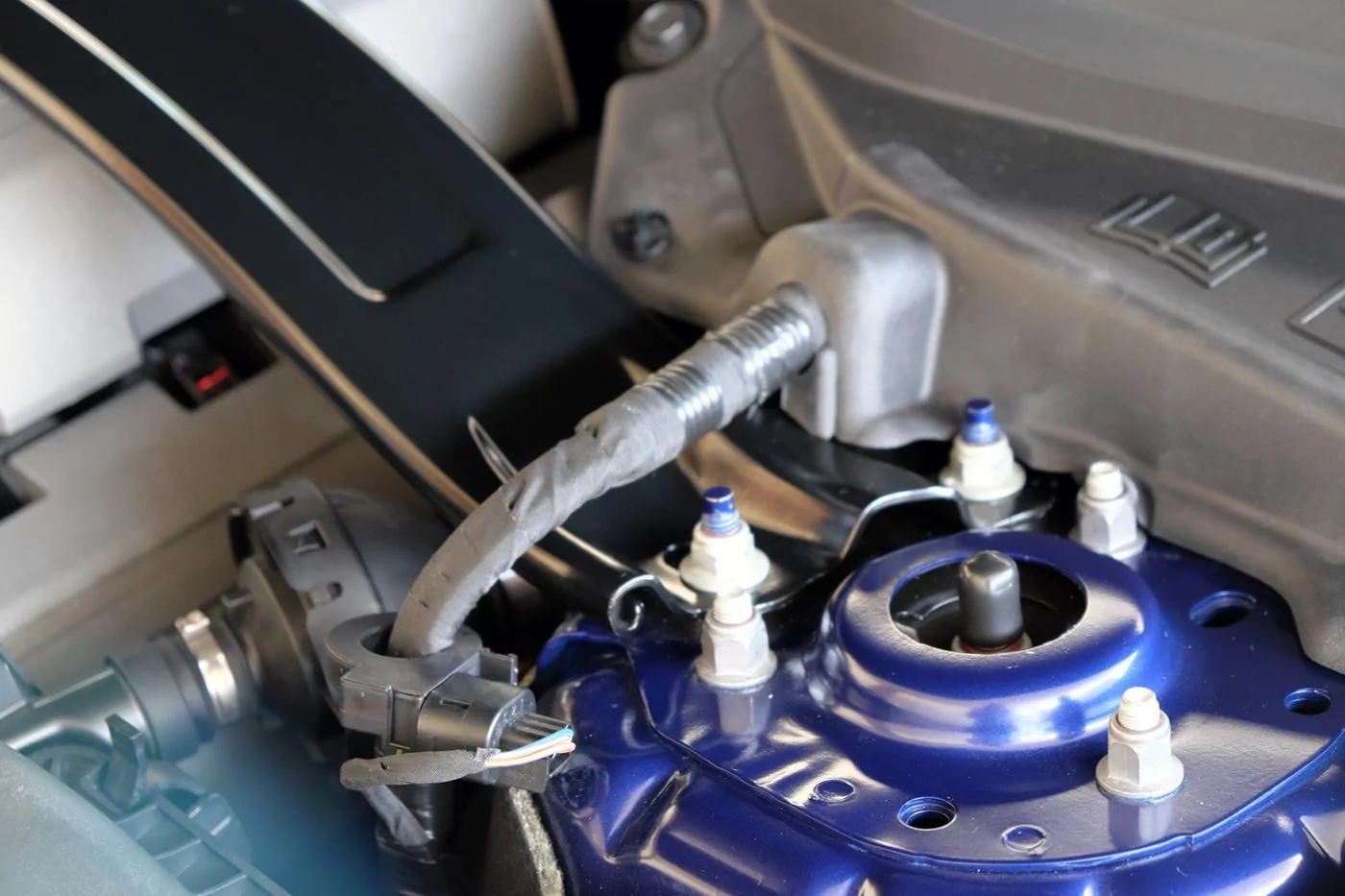

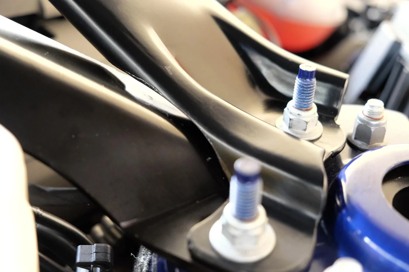

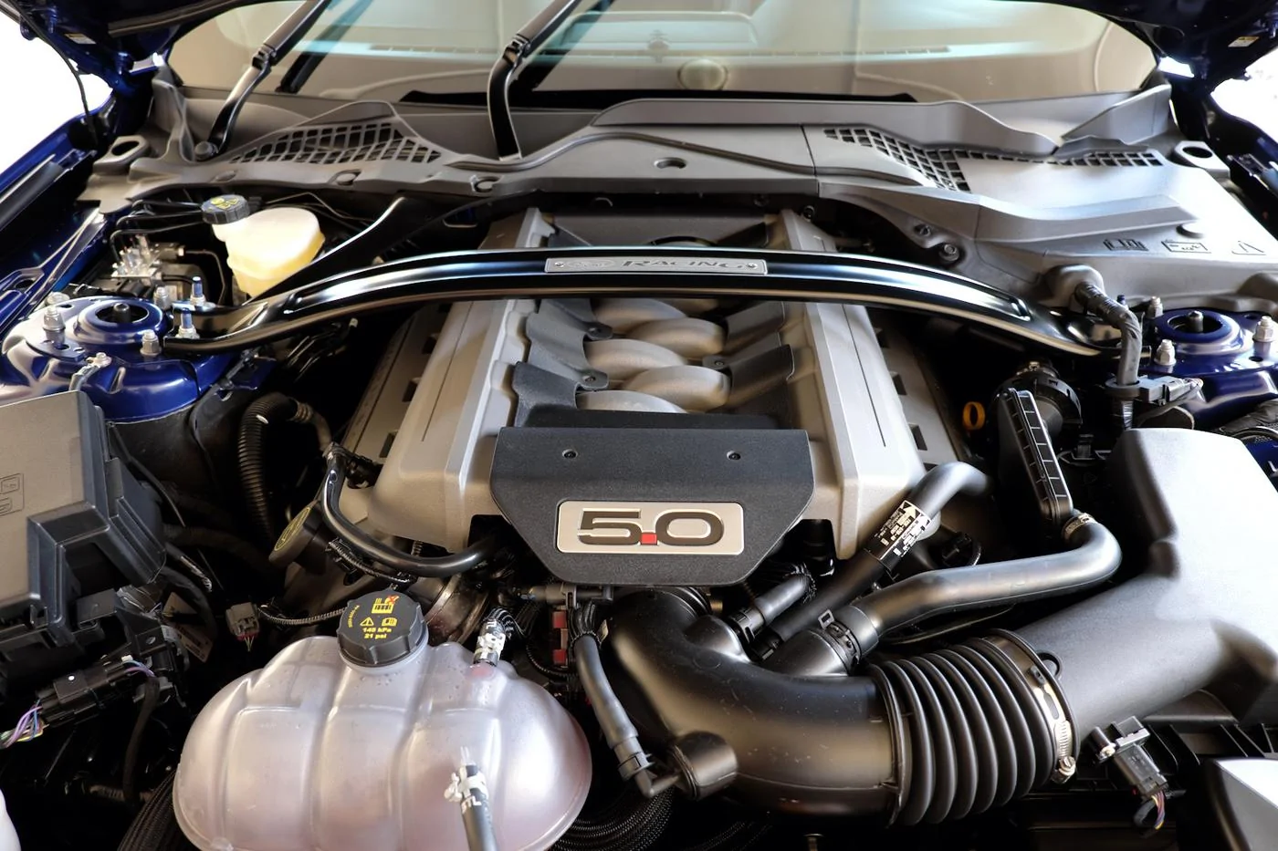

Just installed the Ford Racing Strut Tower Brace across the weekend. :cheers:
https://performanceparts.ford.com/part/M-20201-M
For the install you will need to grind the Drivers side (RHD) underside edge of the tower brace so it doesn't bind against the factory installed cowl extension.
With the part being made specifically for LHD cars there is clear difference between the cutout on one side of the strut brace than the other to obviously accommodate for the cowl extension design on LHD cars.
I can't see any logical reason why they couldn't have designed it to fit both LHD and RHD applications and they may do it in the future but the only way to install it was to grind a section out and repaint. Here's some pics;

Looks smart. I like it. You have done a clean job on the grinding.
Overall was it easy to install?
Just finishes off the engine bay nicely doesn't it. The install itself is very easy given its just a couple of bolts. You don't need to remove the cowl extension or the plastic covers since its already in place so this saves you a lot of time.

Did you paint over the cut so it won't rust?
S550GTRed5
Oct 5, 2014
119
101
Yep absolutely. You can probably see on the pics there is a bit of blob but you cant actually see it unless you go in for a extreme close up as its more underneath than anything and its just slightly built up on the edge:eyebulge:
