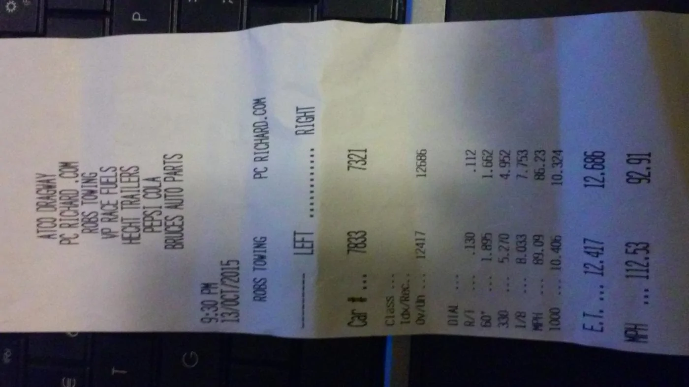

Here's how big a difference it made. The slow slip was from last Tuesday and the faster slip from last night. These are the best slips from both outings.Weather was about the same on both runs.

Has anyone made it in the 11,s with just a tune cai and exhaust on stock tires?No headers either.

Wait, so you ran 12.11 on stock tires with a tune and cai? That's moving son! I going check my plugs shortly.
That 1.82 60ft does not scream factory tires.. but could be. Great times regardless for few mods.
