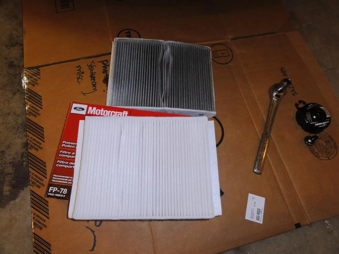

Less than a year and the filter was filthy.

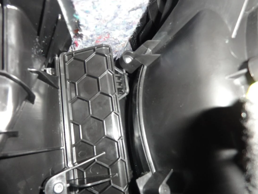

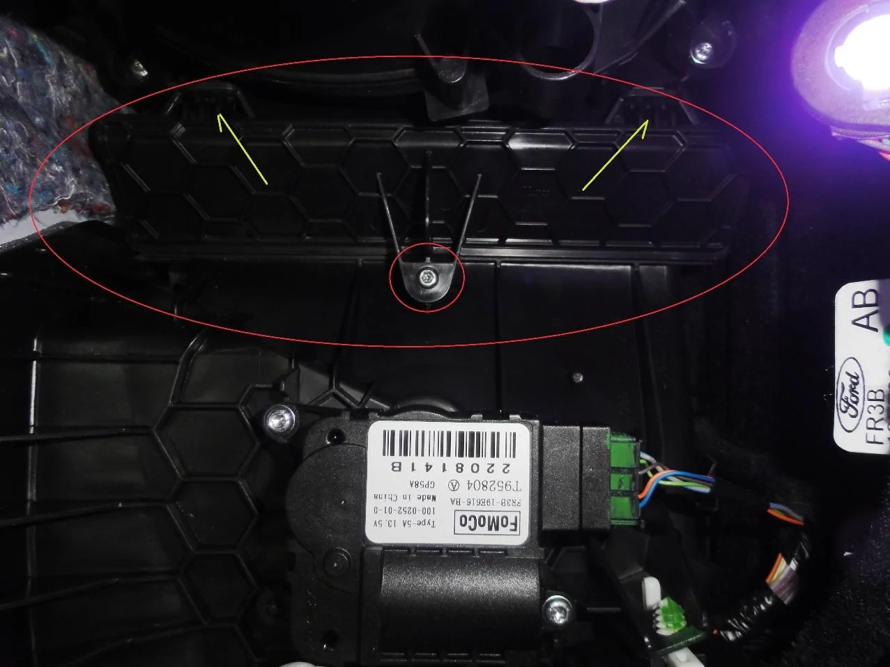

From the foot well looking up behind the glove box, remove the screw with a T-15 Torx bit.
(Owner's Manual list the wrong part number as FP-53. The correct part is FP-78)

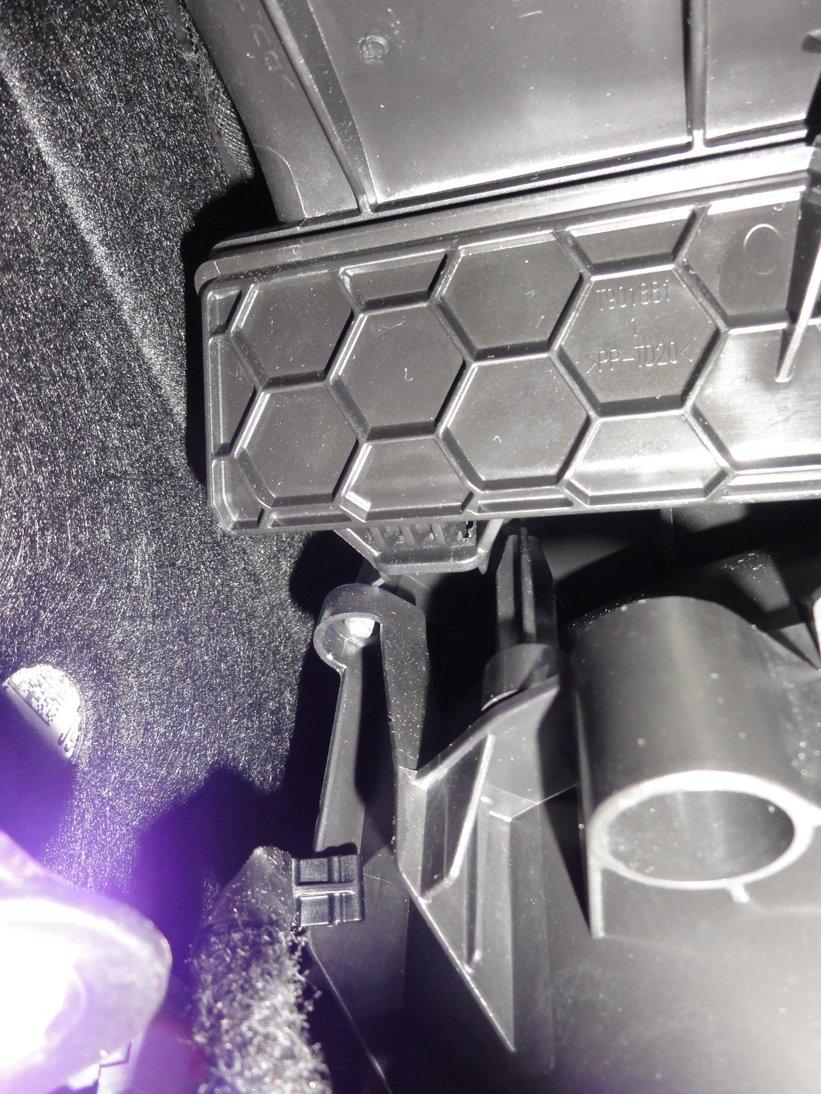

Open the panel being careful not to break the two tabs that secure it into place.
Remove the old Cabin Air Filter and discard.
Gently angle the new filter into place.

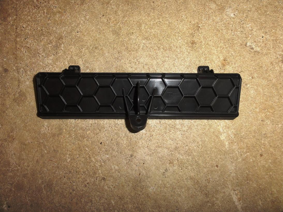

Replace the Cabin Air Filter door. Make sure to secure both tabs in their proper location.
Replace Torx screw and tighten.

Confirmed. Page 419 of the owner's manual reads 20,000 miles.
One thing to note though. In the Owner's manual (page 268) it calls for FP-53 as the correct replacement. That is contradicting the Ford parts website that call for FP-78, which was an exact match for what I used.
