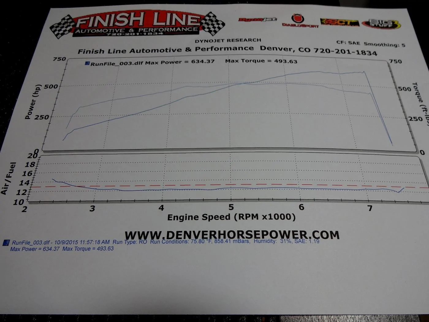

-After first calibration car experienced a no start condition. Reverting to previous calibration allowed start up check. Waiting on update from Lund. -Oct 1st. PM
-Revised calibration received. Car started. Idle and Neutral Rev logs sent. -Oct 3rd. AM
-Cruise Log sent -Oct 6th. AM
-Revised calibration received & loaded. Logs sent Calibration R2. -Oct 6th. PM
-Cruise w/WOT log sent. -Oct 7th. AM
-Final calibration received. -Oct 7th. PM

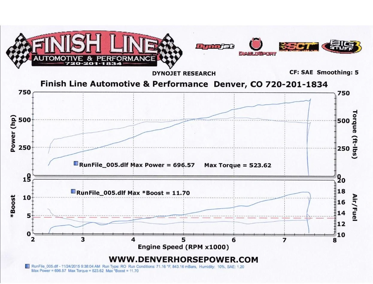

-Installation of 3.6 pulley and intake. Gap plugs at .028 from .032 -Nov 15th. AM
-Revised calibration received. -Nov 16th. PM
Car made it back to the dyno at Finish line performance. The dyno graph from that day is at the very bottom. 696rwhp 523rwtq
