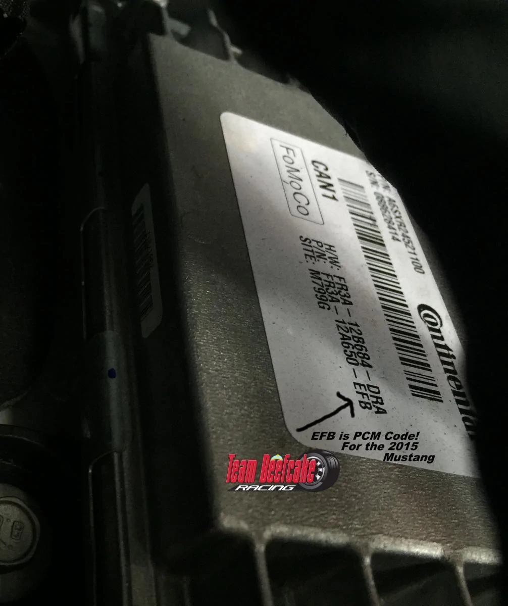

I get a lot of guys ordering tunes, and they are sending the 4 digit code off the sticker, which is always what we used pre 15,
I've included a pic to show what we need for the pcm when ordering the tune.
Hope that helps!!!

Thanks very much! Is that it? Just the 3 letters, EFB? Is it always the same or different per model...i.e. GT, EB ect.

Do you need this code for the tune that comes with the supercharger?

I have always had to provide the strategy code which is 4 characters in order for the tuner to create a tune. With the X4 you just plug it in and it will read it from the PCM.
pulling the strategy out works as well, the strategy is the "end all" as occasionally we have seen the wrong sticker hit a pcm, very very rare, but it does happen

Where is this sticker?
I don't recognize the part. I assume it's in the engine bay and can find it but if someone could point me in the right direction.

It's on the PCM, which is next to the passenger side strut by the fender well inside the engine bay.
