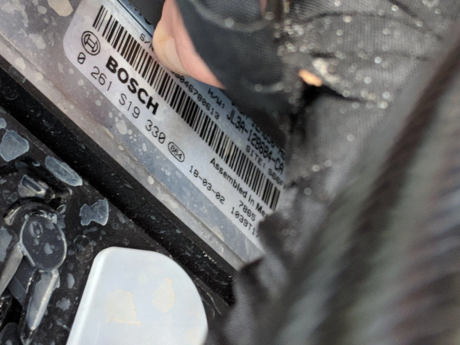

I'm ordering a Lund nGauge tuner and the order form is asking for a "3 digit PCM" code. I followed the instructions on where to find it in the engine bay for a 2015+ but I could not find exactly what they are looking for. It looks like the 2018+ Mustangs again changed things up slightly, as this information is not the same. I have included the best picture I was able to take. Keep in mind that this box has a huge brace attached to it, making trying to get the number neigh in impossible due to how cramped it is there.
Is there another way to get this number? Or is there a different way for 2018's?

On the 18+ applications you can just submit your VIN number and that will work no problem.

Oh great! That should probably be updated on websites like American Muscle, Team Beefcake and the like but hey I'm not their web admin lol.
Thanks for the info!
