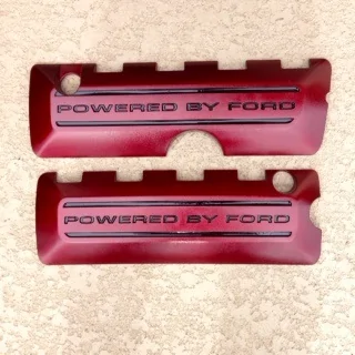

I used Duplicolor's Metalcast red anodized. First laid down a base coat of silver VHT engine enamel. Otherwise, the Metalcast doesn't come out well. Don't ask me how I know this. :doh: Then two good coats of the Metalcast.
Used gloss black Rustoleum enamel to paint the letters and lines. Squirted the black paint into the letters and lines using a big syringe from the kitchen that's used to squirt marinade into turkeys. I'll need a new one of those come Thanksgiving. :) Then a tiny paint brush to spread the paint around inside the letters and lines. Q-tips lightly soaked with paint thinner cleaned the black paint off when my coloring went outside the lines.
The Metalcast red anodized is not an exact ruby red match, but its pretty darn close.

Thanks. Fellow member Redhrse turned me on to the red anodized Metalcast. Hope you find a good color match for your TY. Post some pics when you git er done.

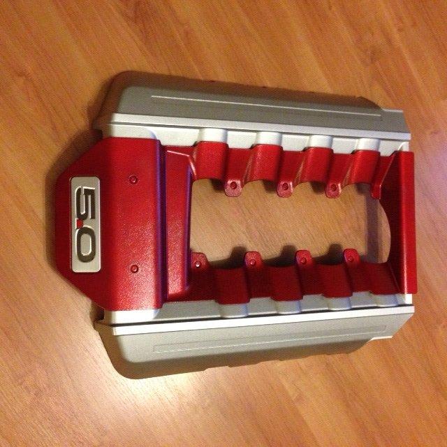

This weekend I painted the engine cover to kinda match the coil covers. As you can see in the pic, I went with silver on the sides and Duplicolor red anodized metalcast for the center piece. Thought doing the whole thing in red would have been a bit too much of that color.

I couldn't for the life of me figure out how to paint the letters. Originally was trying with a tiny brush, but black paint would get on my red in places I didn't want it. I would of though paint thinner would take off the extra black plus red. Maybe when I feel up to it, I will retry that.

One way to paint recesses is to paint the entire object first and let it fully cure for a few days, then you can just mask off most of the object. Then just hit it with black paint and use a damp stiff sponge to wipe across the top of the part. The little bit of dampness and the stiffness of the sponge will wipe the paint off and leave the black in the recess.
If you look up in my post, I mention that I used a big turkey syringe to quirt the black paint into the letters and lines. And then used a tiny brush to get the black paint into the nooks and crannies of the letters. Q-tips dampened with paint thinner removed the black paint when I got a little outside the letters. Took a little while but it worked pretty well.
