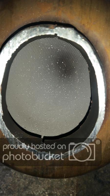

Well ten years later we are proud to say once again that we are first to market with offroad lead pipes for the 2015 GT. When it comes to making power one of the most restrictive parts of the exhaust is the catalytic converters, and the S550 S550 Mustang GT is no different, actually it is among the worst. The factory lead pipes measure a measly 2.25in in Diameter and in some parts even less that 2in.

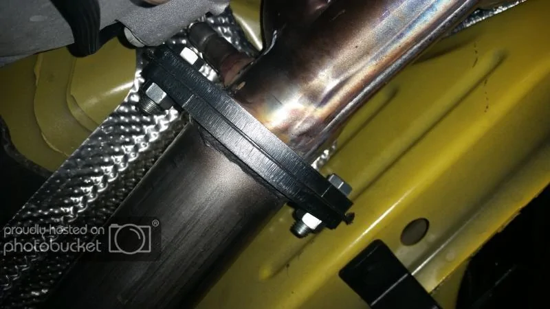

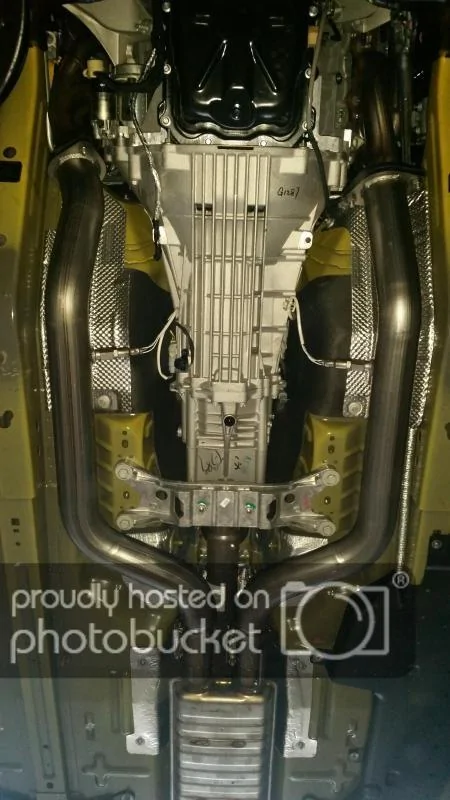

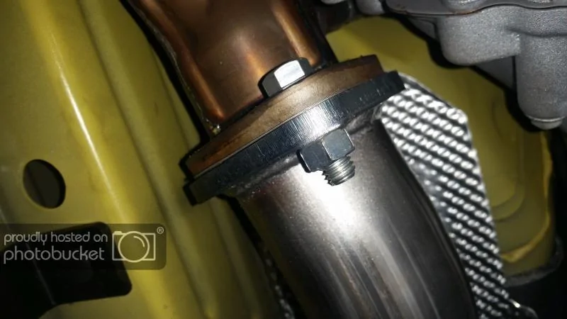

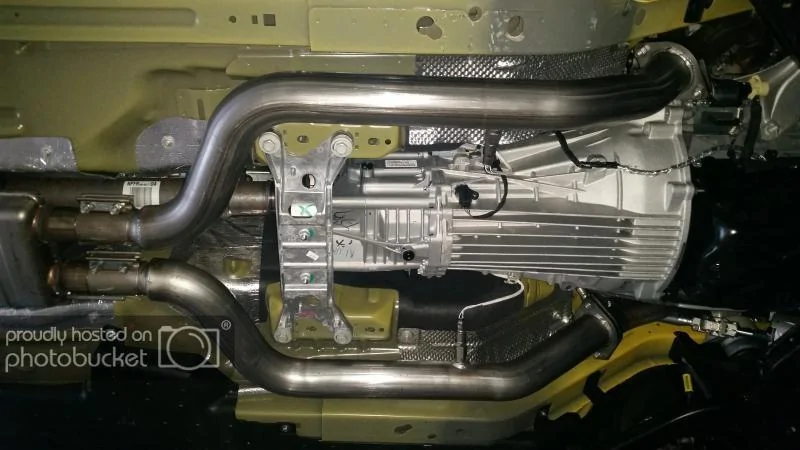

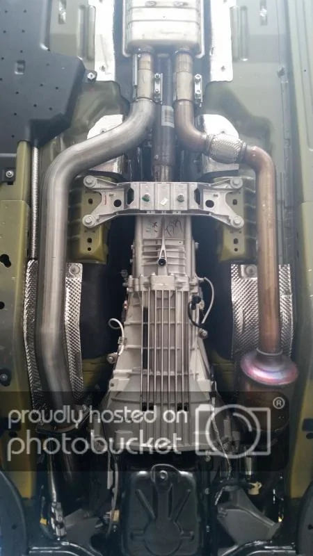

Enough talking here are the pictures From Factory piping to MAK O/R Leads:

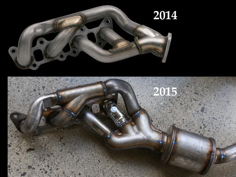

Looks Kind of Restrictive:

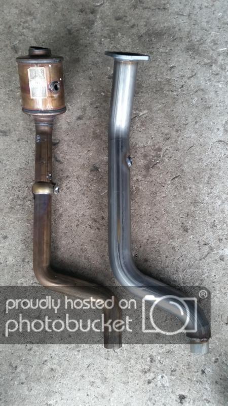

Stock Vs MAKs
Off Car Comparison

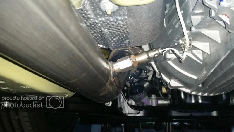

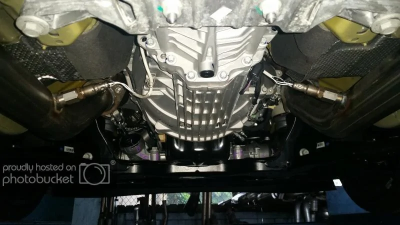

Plenty of Room for the Sensors

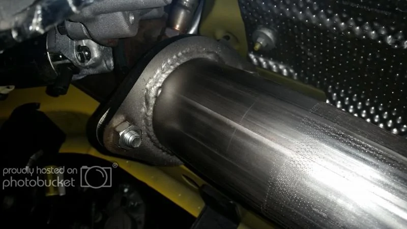

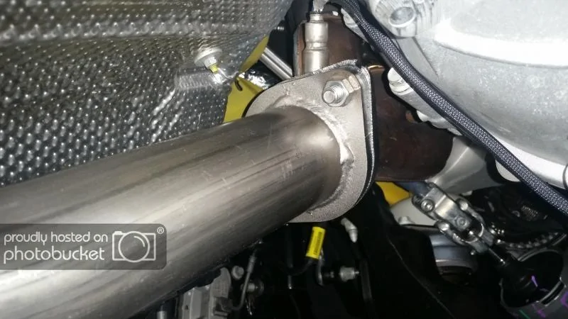

Good Clearance at the Header
FInished Product:

Looks awesome! a little off topic but will you guys be making 3 inch lead pipes with high flow cats? Or would that not even be much of a difference vs the stock pipes

Wow....I am very curious to see these with an aftermarket catback and the power this combo will make.
This factory pipes are tiny!!

Yes we will be making a high flow catted version. They will make a difference, just the amount of airflow difference will be worth it even if ts catted.

That is exactly what we are thinking. We will see very soon.

Nice.. We did the same thing with our supercharged 2015. I took the flange from the driver's side cat, cut it off, and welded it to the driver's side manifold. In the middle of building an x-pipe in 2.5" to connect after the stock resonator. That should make it 2.5" all the way back.
