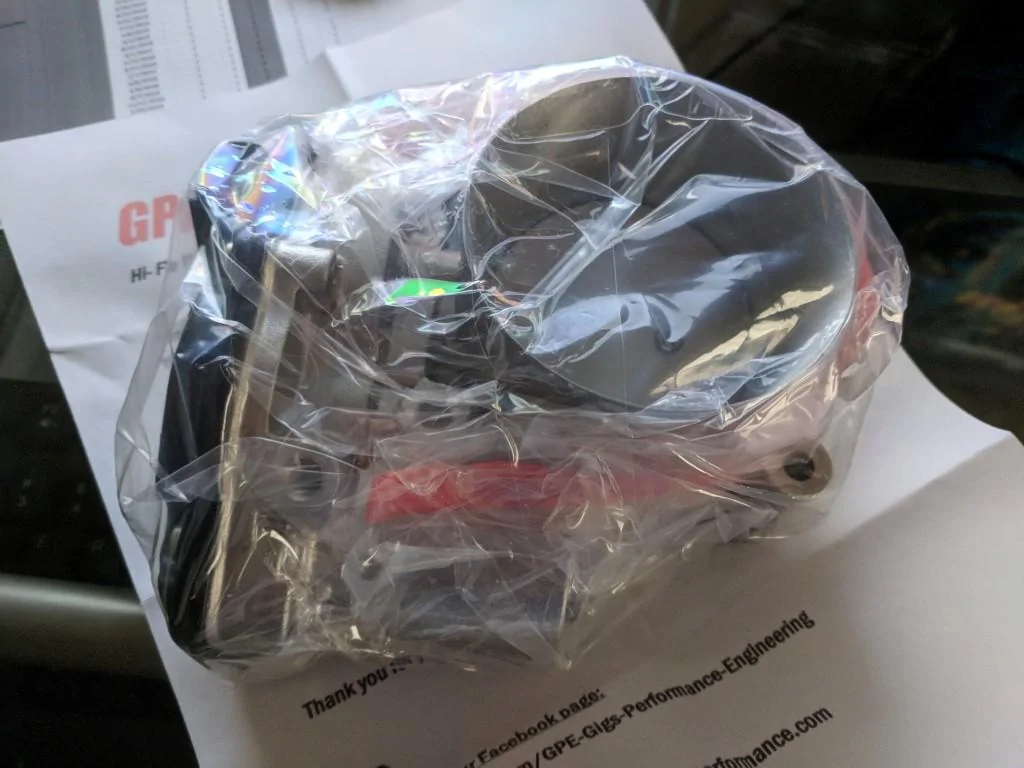

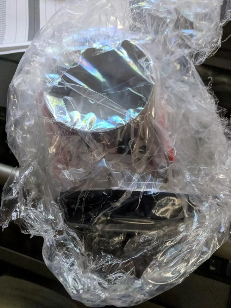

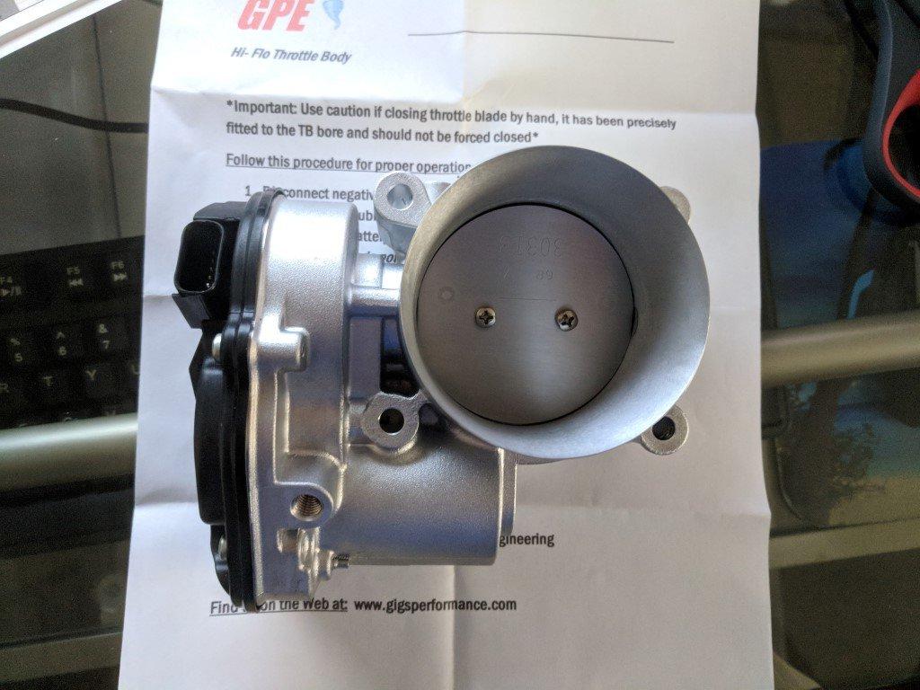

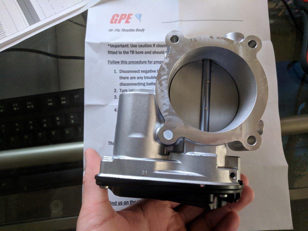

Unfortunately I didn't grab any side by side pictures of the ported TB compared to the stock TB, but I've attached some pictures of each to this post.
