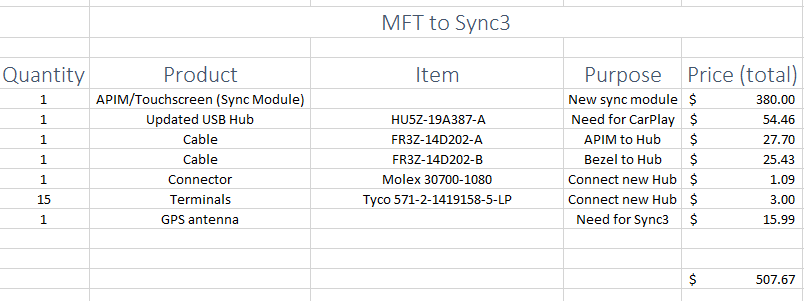

So to make sure I understood correctly, this is all you'd need to go from MFT to Sync3?
It might help others see it visually and put a price on it

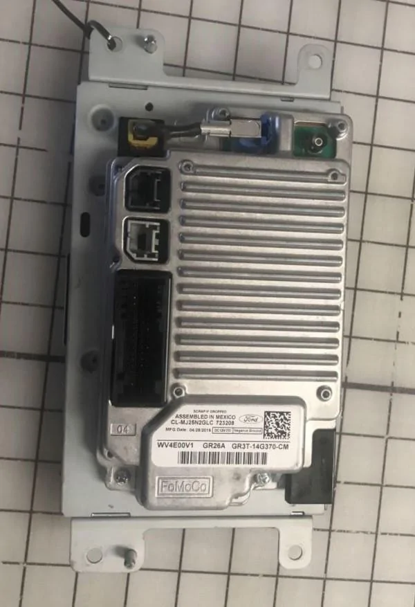

Will a F150 APIM
Do you guys know if this APIM from a 16 F150 would work? I really need a Sync 3 upgrade
You'll just have to try it. If the brackets are different [MENTION=29252]mgrey[/MENTION] had some that he was selling. Most likely it will work if you change all of the as built data with FORScan
