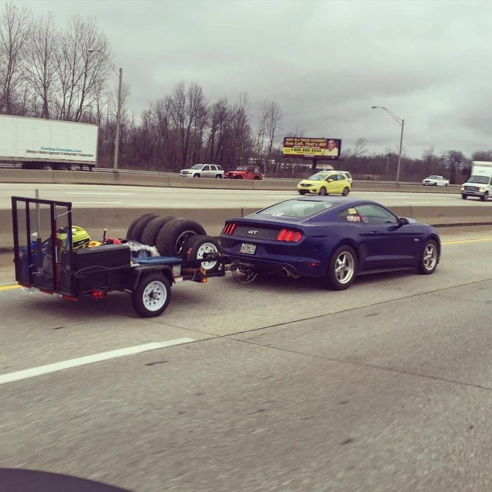

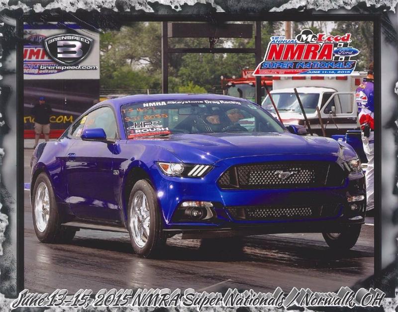

This is RBS550`s dad he is busy working long hours at nuke plant, but he is using the Ford Racing oil filter with Mobil 1 5W20 and has over 20K on his stang mostly pulling a trailer to drag strips and NMRA races.I could not even count the 1/4 miles passes shifting at 8K and no problems been racing and using this oil and FMS filter for the last 16K miles. I also use it but my car has not seen the action his has:thumbsup:
