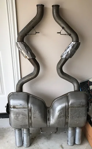

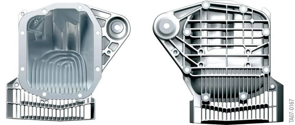

Attached photos are factory parts off a BMW M3 V8. Notice the heat shields on the exhaust. The differential on that car also has a nice finned cover with a large heat sink.
IMHO these are small things Ford could've/should've included from the factory, especially on something like a PP2.
Most likely your drive organizer guy has a fist year 350 without the track pack (no diff cooler).

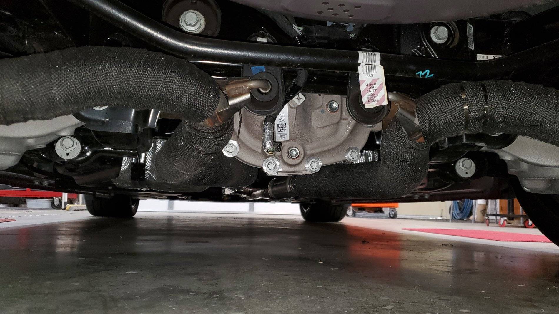

Here's a pic of the exhaust wrapped on my PP2. Between the fluid change and wrap I've had no issues with over heating, and we've had 100 degree days.
