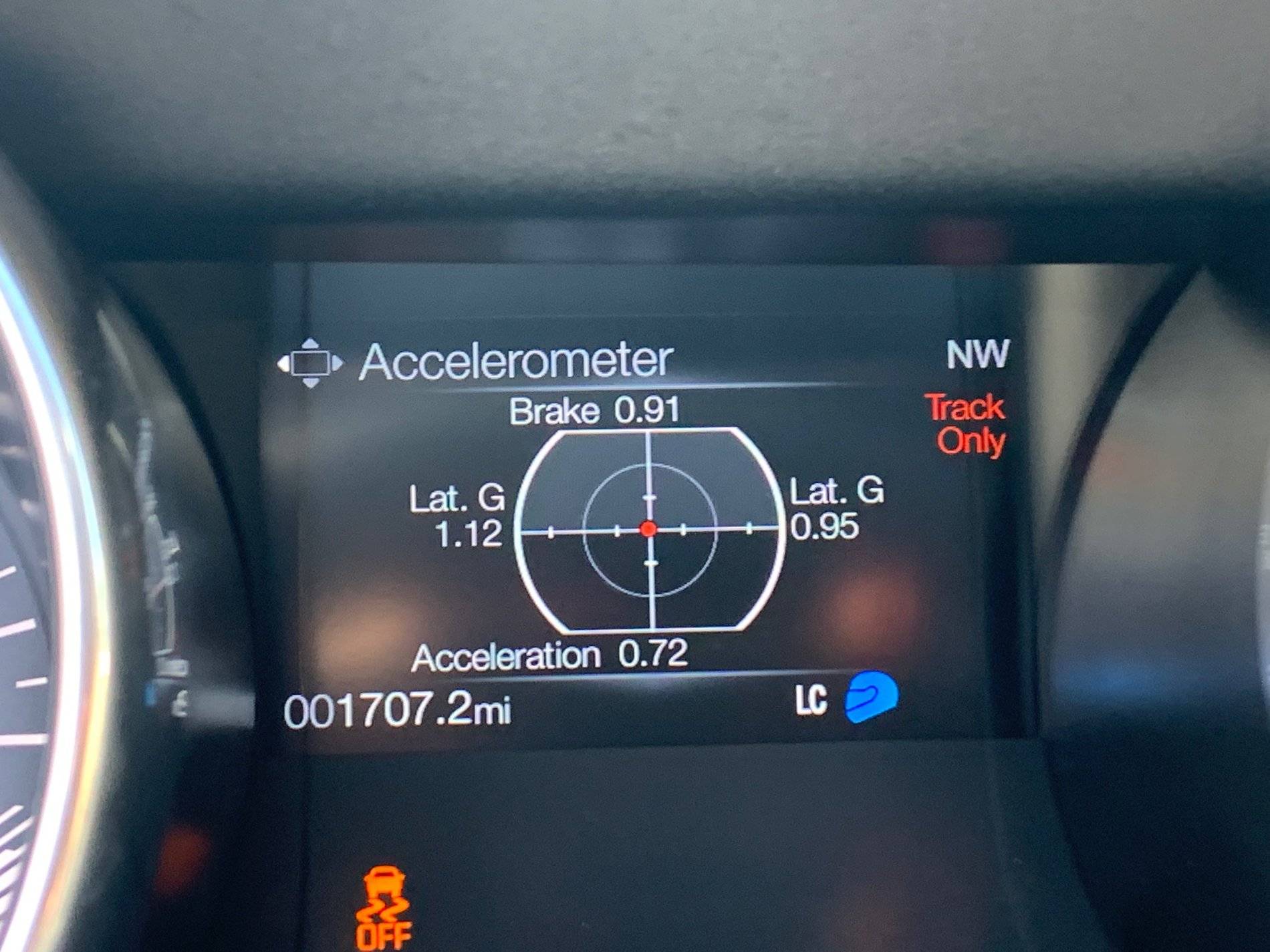

New owner of a PP2 here and absolutely love it so far. Today however I ran into my first gripe with the car. Took it through my favorite backroads and got the rear axle temp overheat warning. I had read all about the car needing a diff cooler for track use (and that is also mentioned in the supplemental PP2 manual) but I never thought it would be an issue with street use. A little disappointing having to slow down not even half way through my usual run. Ambient temps were only in the mid to high 80s.
Another thing I've noticed is being unable to apply throttle early through a turn and that's before any sign of wheel spin whatsoever. I have a feeling the computer senses the lateral Gs and decides not to let you throttle through no matter what. This seems to have been resolved with holding the traction off button until it says "Advancetrac" disabled instead of just traction off.
Perhaps one more little thing is that I find the throttle mapping to be a little on the lazy side. I do my own heal toes and I feel I have to hit the gas more than I'd want to. Sport + and track mode seem a little better but I wish I could have a snappier throttle response without being forced into the stiffer suspension setting. Or maybe I just need to get more used to the car. I just can't nail the heal toes 100% perfect just yet.
Beyond that I gotta say the car has met and exceeded all my expectations as a fun driver's car. Clutch and shifter a peachy despite the forums leading me to believe I'd at the minimum need a spring a bracket. The car looks and sounds awesome but it's so much more than that. Handling and grip are world class even with factory alignment (a bit light on negative camber). Very neutral and confidence inspiring which makes the car super fun! Nailed 1.12G on a smooth right hander!
