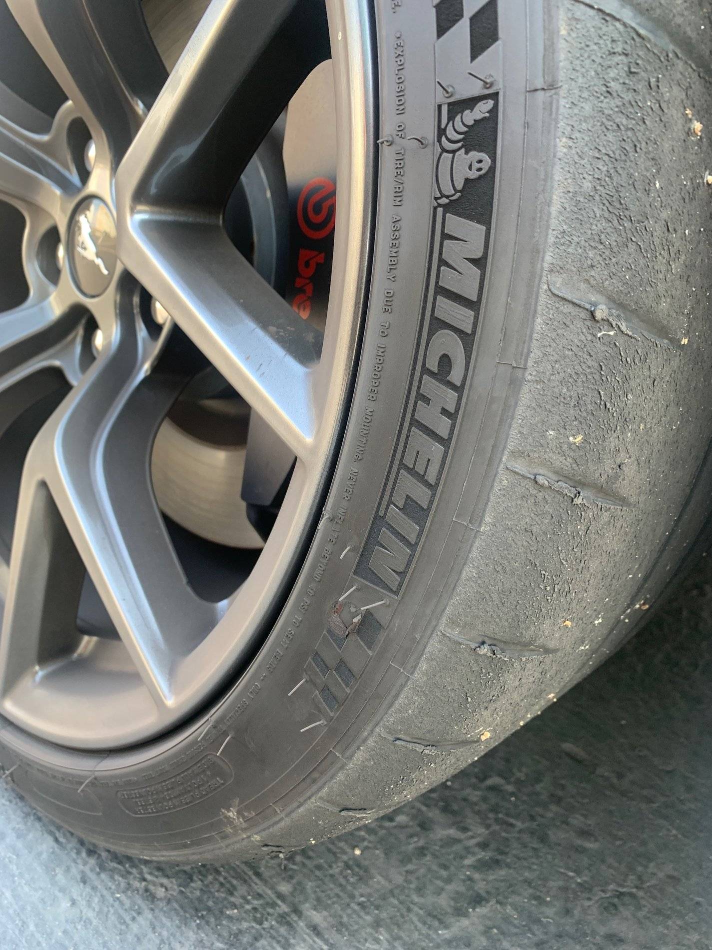

I'm a buyer if anyone has a set of cup 2s they've removed and don't plan on using.

I've got a set that went from the dealership to the tire shop I'll let go. They are off my 2019 PP2.I'm a buyer if anyone has a set of cup 2s they've removed and don't plan on using.
I love those tires.I'm a buyer if anyone has a set of cup 2s they've removed and don't plan on using.
