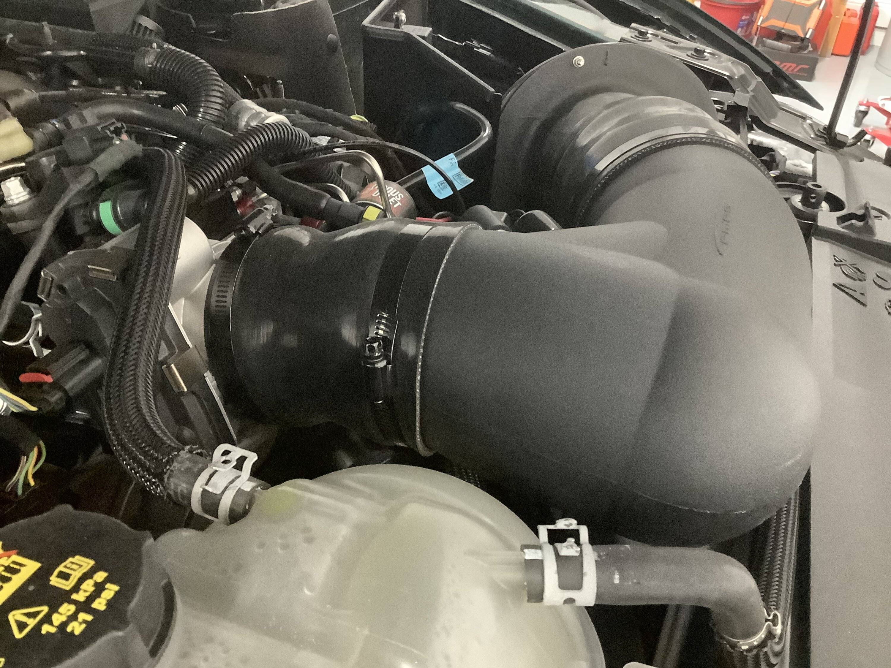

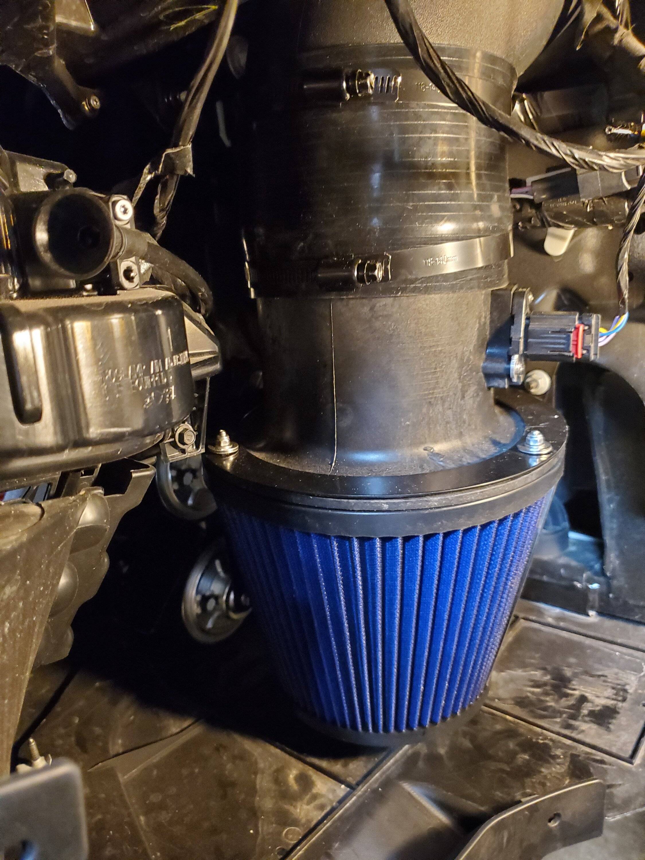

It looks like it fits pretty good. Did you just need to step away yesterday, regroup and try it again? How would you rate the overall fitment of the fender kit? Would you buy it again or stick with the standard PMAS?Well there she blows.
Definitely the intake I'd get if I were really interested in an intake.Well there she blows.

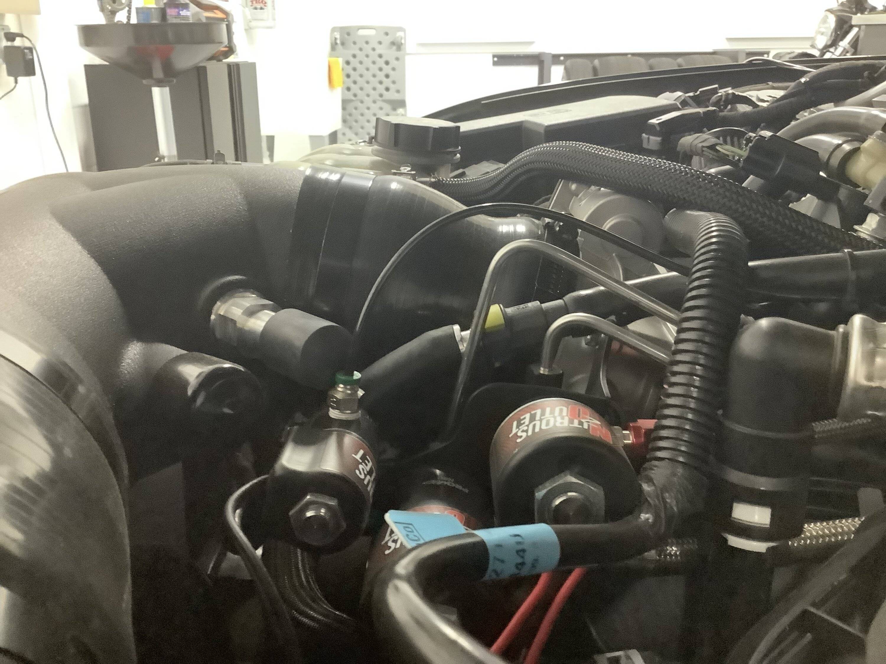

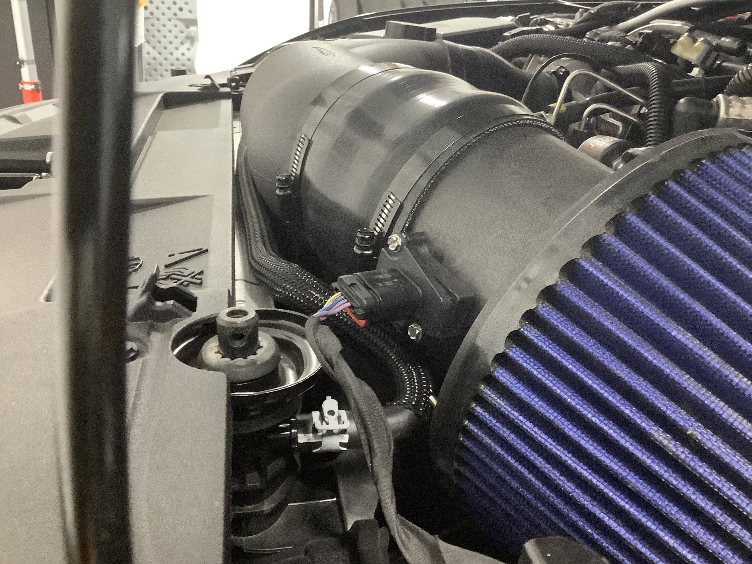

Yeah I had more time today & I wasn't pushed in far enough on the throttle coupler. I still feel like it kind of gets pushed down a bit when I close the hood, but really hard to tell since you can't see anything from that pov. What I don't like is where the AF sensor sits. I had a stock box so I will update as soon as I run it, figure out how to use this BDX & figure out how to data log, down load tune & all that. I came from an Ngauge so let's hope it's as simple as that.It looks like it fits pretty good. Did you just need to step away yesterday, regroup and try it again? How would you rate the overall fitment of the fender kit? Would you buy it again or stick with the standard PMAS?
If it works as expected, I'll be happy with it for the next few years until I figure out if I'll go FI or not.Definitely the intake I'd get if I were really interested in an intake.

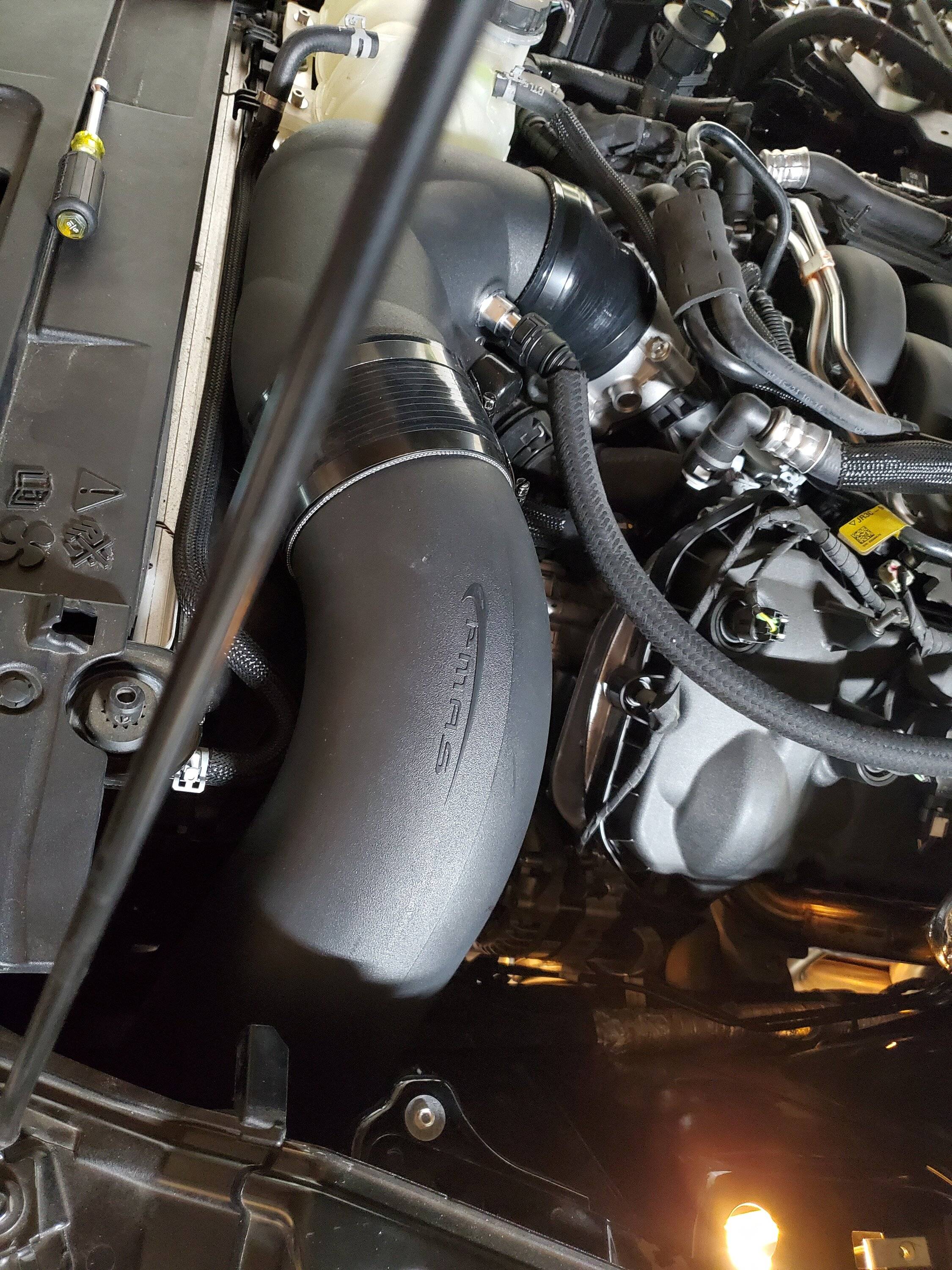

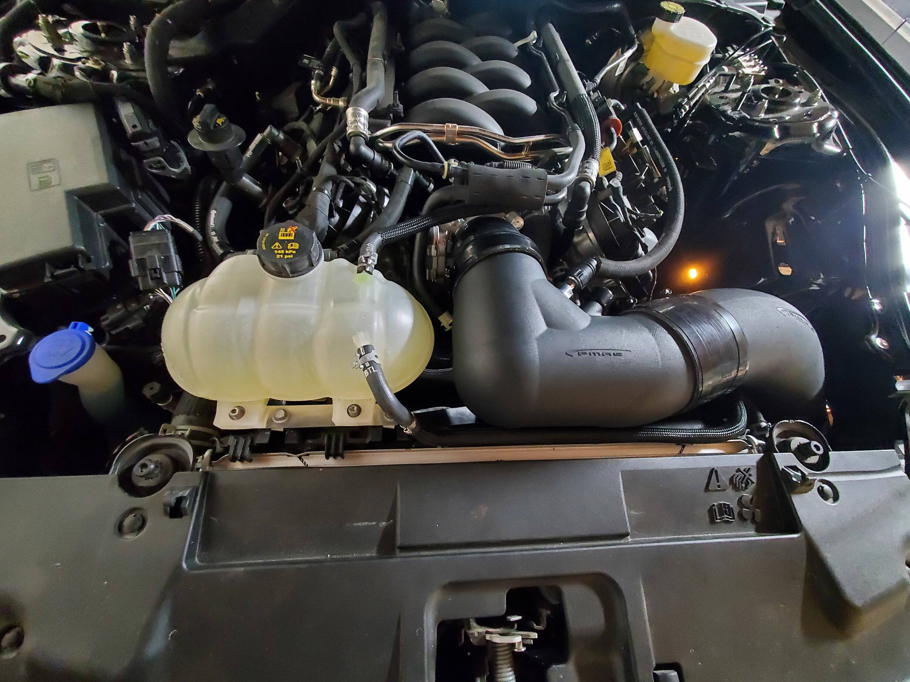

The fact that the PMAS intake tube would hit my hood blanket and the fan shroud, is one of the reasons why I removed the blanket and modified the fan shroud. The other reason was for additional airflow.Yeah I had more time today & I wasn't pushed in far enough on the throttle coupler. I still feel like it kind of gets pushed down a bit when I close the hood, but really hard to tell since you can't see anything from that pov. What I don't like is where the AF sensor sits. I had a stock box so I will update as soon as I run it, figure out how to use this BDX & figure out how to data log, down load tune & all that. I came from an Ngauge so let's hope it's as simple as that.

Yeah it's a bit annoying. I'm sure many are ok with it, but the way I see it, for what things costs, they should fit right. If I knew I had to remove some of my insulation (which I don't believe I have to) I would of stayed with the stock box. But the mod bug bit, & for the little bit of cash I had to burn, this fit the bill.The fact that the PMAS intake tube would hit my hood blanket and the fan shroud, is one of the reasons why I removed the blanket and modified the fan shroud. The other reason was for additional airflow.
