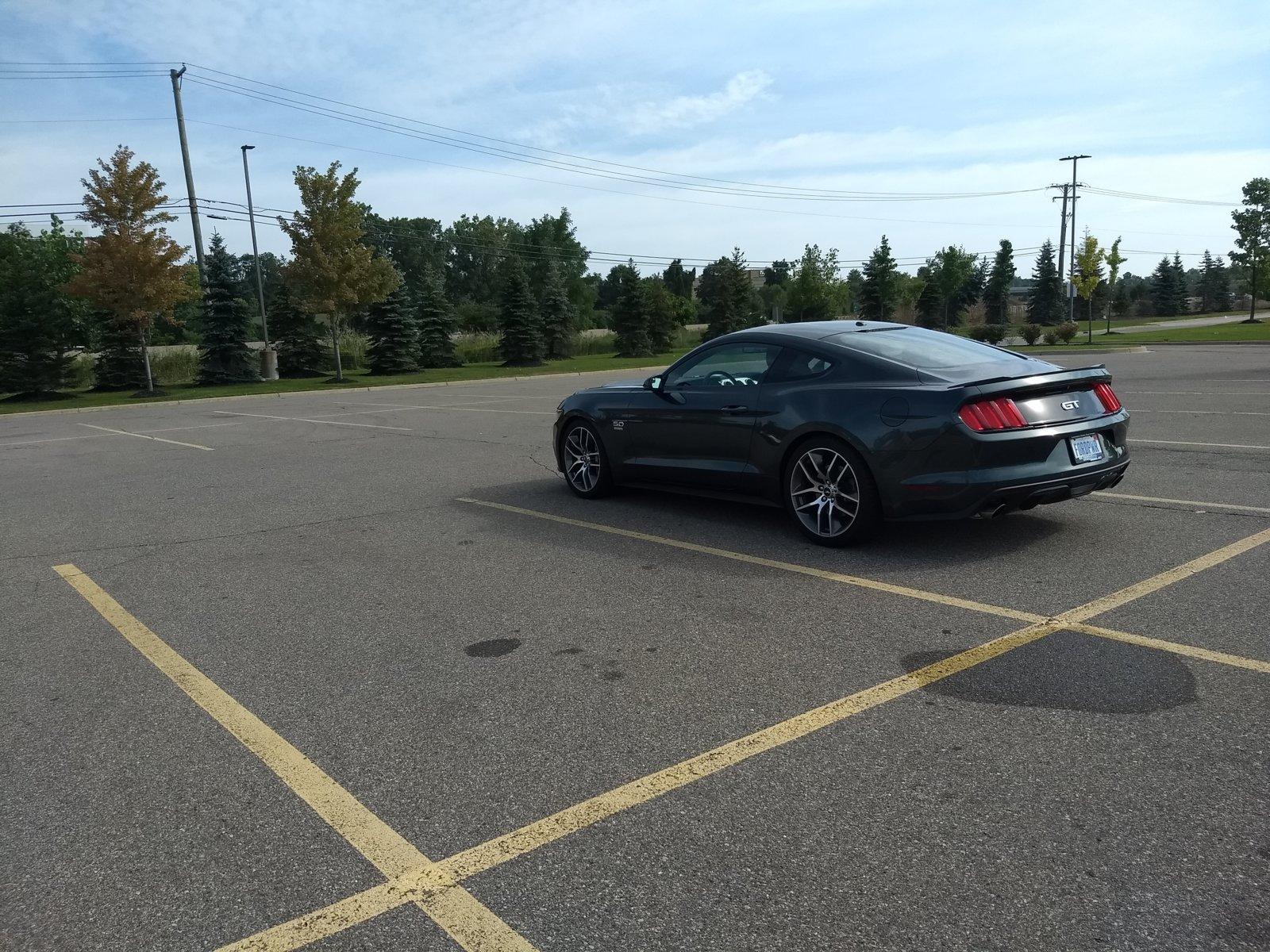

I'm at the restaurant meeting my daughter and brother for brunch and have a hundred miles on the car now. It runs absolutely perfect. Though the power might be down a bit it was worth it to get it out of LMS.
