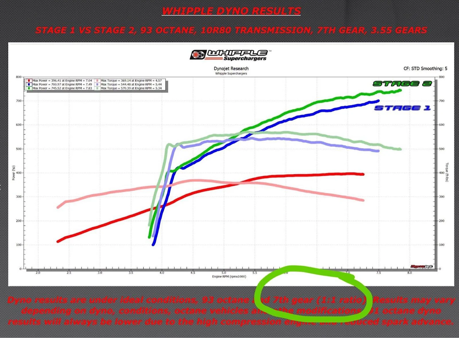

I havent really done a ton of research on the subject, but i thought most FI cars, ie whipple, paxton, VMP and such, are making easy 650-700's on 91? ill be honest dont know much about this blower here

Those 700 hp numbers refer to flywheel hp. The new Whipple (according to their website) states 730hp/680tq for the 2018-2019 Mustangs. Their description states these numbers as the flywheel hp, not RWHP. I think the Magnuson puts down 580 RWHP from dyno runs people have listed, so it's close to the Stage 1 Roush system of 650 flywheel I imagine.
Whipple are most certainly referring to power at the wheels.
Not sure where you got the idea that it was engine Hp.
There are plenty people making 700 wheel with different setups (Whipple, Procharger for sure) on pump.
